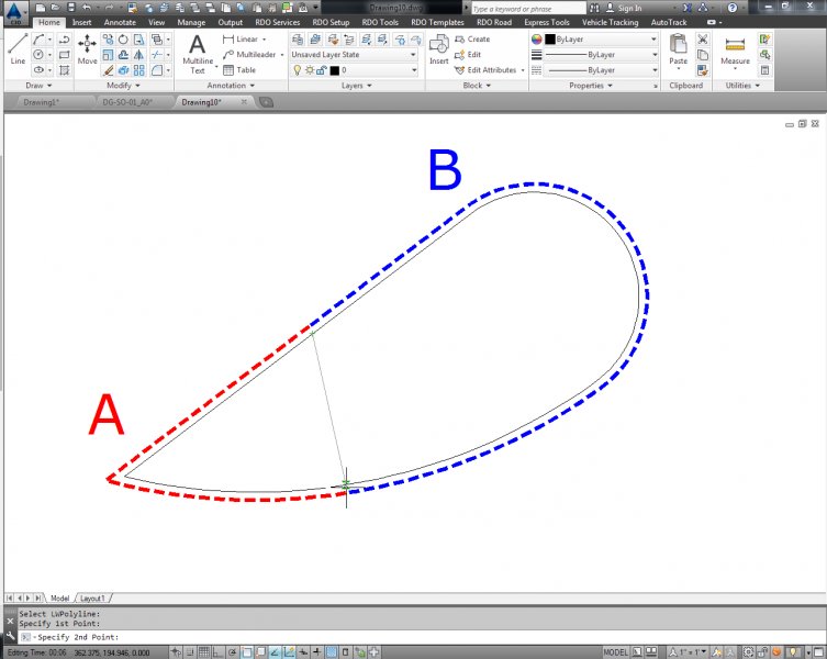

woodman78 Posted June 10, 2015 Author Posted June 10, 2015 Tombu. I downloaded your updated code and it works great only that I don't think I explained myself very well earlier. Why using the routine after selecting the polyline and choosing points to offset between the user selects a side to offset to but I think it should be to offset inside or outside and with the additional option to specify what side of then line between the selected points. I am trying to make it as clear as possible but I don't know if I am succeeding very well. I include a drawing that may help to explain. How do I choose between portion A or portion B of the polyline? Quote
tombu Posted June 10, 2015 Posted June 10, 2015 Try this one: ;;------------------=={ Offset LWPolyline Section }==-------------------;; ;; ;; ;; This program prompts the user to specify an offset distance and to ;; ;; select an LWPolyline. The user is then prompted to specify two ;; ;; points on the LWPolyline enclosing the section to be offset. The ;; ;; progam will proceed to offset all segments between the two given ;; ;; points to both sides by the specified distance. ;; ;; ;; ;; The program is compatible with LWPolylines of constant or varying ;; ;; width, with straight and/or arc segments, and defined in any UCS ;; ;; construction plane. ;; ;;----------------------------------------------------------------------;; ;; Author: Lee Mac, Copyright © 2013 - www.lee-mac.com ;; ;;----------------------------------------------------------------------;; ;; Version 1.0 - 27-12-2012 ;; ;; ;; ;; First release. ;; ;;----------------------------------------------------------------------;; ;; Version 1.1 - 05-04-2013 ;; ;; ;; ;; Fixed bug when offsetting polyline arc segments. ;; ;;----------------------------------------------------------------------;; ;; Version WM78 - 06-10-2015 ;; ;; http://www.cadtutor.net/forum/showthread.php?92673-Offset-only-a-section-of-a-closed-polyline&p=634498#post634498#14 ;; Set offset options Inside, Outside, or Both. ;; ;;----------------------------------------------------------------------;; (defun c:offsec ( / d e h l m n o p q w x z str1) (if (null *off*) (setq *off* 1.0) ) (initget 6) (if (setq d (getdist (strcat "\nSpecify Offset <" (rtos *off*) ">: "))) (setq *off* d) (setq d *off*) ) (while (progn (setvar 'errno 0) (setq e (car (entsel "\nSelect LWPolyline: "))) (cond ( (= 7 (getvar 'errno)) (princ "\nMissed, try again.") ) ( (null e) nil) ( (/= "LWPOLYLINE" (cdr (assoc 0 (entget e)))) (princ "\nObject is not an LWPolyline.") ) ( (setq p (getpoint "\nSpecify 1st Point: ")) (setq p (vlax-curve-getclosestpointto e (trans p 1 0))) (while (and (setq q (getpoint (trans p 0 1) "\nSpecify 2nd Point: ")) (equal p (setq q (vlax-curve-getclosestpointto e (trans q 1 0))) 1e- ) (princ "\nPoints must be distinct.") ) (initget "Inside Outside Both") (or (setq str1 (getkword " [inside/Outside/Both] <Both>: ")) (setq str1 "Both") ) (if q (progn (if (> (setq m (vlax-curve-getparamatpoint e p)) (setq n (vlax-curve-getparamatpoint e q)) ) (mapcar 'set '(m n p q) (list n m q p)) ) (setq e (entget e) h (reverse (member (assoc 39 e) (reverse e))) h (subst (cons 70 (logand (cdr (assoc 70 h)) (~ 1))) (assoc 70 h) h) l (LM:LWVertices e) z (assoc 210 e) ) (repeat (fix m) (setq l (cdr l)) ) (if (not (equal m (fix m) 1e-) (setq x (car l) w (cdr (assoc 40 x)) l (cons (list (cons 10 (trans p 0 (cdr z))) (cons 40 (+ w (* (- m (fix m)) (- (cdr (assoc 41 x)) w)))) (assoc 41 x) (cons 42 (tan (* (- (min n (1+ (fix m))) m) (atan (cdr (assoc 42 x))) ) ) ) ) (cdr l) ) ) ) (setq l (reverse l)) (repeat (+ (length l) (fix m) (- (fix n)) -1) (setq l (cdr l)) ) (if (not (equal n (fix n) 1e-) (setq x (car l) w (cdr (assoc 40 x)) l (vl-list* (list (cons 10 (trans q 0 (cdr z))) '(40 . 0.0) '(41 . 0.0) '(42 . 0.0) ) (list (assoc 10 x) (assoc 40 x) (cons 41 (+ w (* (/ (- n (max m (fix n))) (- (1+ (fix n)) (max m (fix n)))) (- (cdr (assoc 41 x)) w) ) ) ) (cons 42 (tan (* (if (< (fix n) m) 1.0 (- n (fix n))) (atan (cdr (assoc 42 x))) ) ) ) ) (cdr l) ) ) ) (setq o (vlax-ename->vla-object (entmakex (append h (apply 'append (reverse l)) (list z))) ) ) (cond ((= str1 "Inside") (vl-catch-all-apply 'vla-offset (list o (- d))) ) ((= str1 "Outside") (vl-catch-all-apply 'vla-offset (list o d)) ) ((= str1 "Both") (vl-catch-all-apply 'vla-offset (list o d)) (vl-catch-all-apply 'vla-offset (list o (- d))) ) ) (vla-delete o) ) ) ) ) ) ) (princ) ) ;; Tangent - Lee Mac ;; Args: x - real (defun tan ( x ) (if (not (equal 0.0 (cos x) 1e-) (/ (sin x) (cos x)) ) ) ;; LW Vertices - Lee Mac ;; Returns a list of lists in which each sublist describes the position, ;; starting width, ending width and bulge of a vertex of an LWPolyline (defun LM:LWVertices ( e ) (if (setq e (member (assoc 10 e) e)) (cons (list (assoc 10 e) (assoc 40 e) (assoc 41 e) (assoc 42 e) ) (LM:LWVertices (cdr e)) ) ) ) ;;----------------------------------------------------------------------;; (vl-load-com) (princ (strcat "\n:: OffsetSection.lsp | Version 1.1 | \\U+00A9 Lee Mac " (menucmd "m=$(edtime,0,yyyy)") " www.lee-mac.com ::" "\n:: Type \"offsec\" to Invoke ::" ) ) (princ) ;;----------------------------------------------------------------------;; ;; End of File ;; ;;----------------------------------------------------------------------;; Quote
woodman78 Posted June 10, 2015 Author Posted June 10, 2015 Thanks Tombu but I hoping to be able to select whether I want to offset portion A or portion B of the line inside or outside based on the above diagram. Quote
tombu Posted June 10, 2015 Posted June 10, 2015 Thanks Tombu but I hoping to be able to select whether I want to offset portion A or portion B of the line inside or outside based on the above diagram. The polyline has a start and end and the lisp will work on anything along it. Even though it's closed there's no way lisp can cross the origin (Current vertex 1 in Properties) to draw the other offset portion that I know of. Sorry, Quote

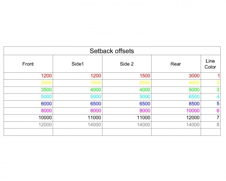

Hsanon Posted September 14, 2015 Posted September 14, 2015 Tombu, Your modification is great, and will really help me, if it can be updated a bit..... I am just not adept at coding,(and especially Lee's code ;-)) I need to offset site plans to create setback lines at different distances....... (had started a new thread some time back for this... but this thread is pretty close to it) Can we choose the two points as per your modification This could be called front setback. Always choose Inside offset Offset them at fixed known distances have each offset of a different colour 1,2,3,4,5..... Continue with Side 1 setback (with different fixed offset distances) and Side 2 setback (with different fixed offset distances) and Rear setback (with different fixed offset distances) The resultant coloured setback lines could be matched and manually filletted to get continuous setback lines am attaching a drawing trying to explain..... thanks for your help..... site setback.dwg Quote
Hsanon Posted September 14, 2015 Posted September 14, 2015 Attaching the offset distances and the line colours (just in case it is possible) ***** fingers crossed****** Basically we will need to identify each segment ..... if its front, the front setback offsets will need to be done, if the segment is identified as S1, the side one segments need to be offset ted... and so on.... Side 2 & rear.... tough one....... ????? Quote
