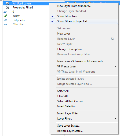

Have any of you ever seen the icons in the Layer Manager in the image below?
My google-fu has let me down, I can't find anything on it. Apparently (because I can't replicate in on my computer) the Layer Manager looks this way if he opens a new dwg from this particular template without having any other dwg open. If he has another dwg open, it looks normal.

It looks like he may have the show filters in layer list option selected.
I suspected that it was something to do with filters - the icon hinted as much!
What version is your image from Rob? I don't get the same icons that you do, I am wondering if those icons have changed over the years.
I did not know the answer. The filter icon was what got me there.
I'm on MEP 2014.
Hmm. Still weird then, in 2015 and 2016 I have these icons when I tick Show Filters ... so almost, but not exactly.

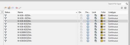

This is annoying! It is not consistent, I can't replicate it on my computer (and now it has disappeared on the clients computer as well). But those icons look like real icons, which makes me think that is a setting somewhere that I can't find!
In the image in your first post, are those names the names of filters?
I don't see any icons under status in your last post.
Maybe it has to do with the state of individual layers in a particular filter?
It sounds inconsistent. I would chalk it up to buggy icons. Until my recent computer upgrade, I would get glitches in the layer manager from time to time. That was over multiple versions and multiple computers. A restart usually fixed them. Our CAD manager has a solution for persistent buggy icons. I'll ask him about it when he gets in. I think it has something to do with the support paths.
No, no icons at all when I have the Layer Filters displayed in the list.
I just looked at the original file, and the image in the first post are just of layers, no filters.
It might be something about the status of the layers, I have had that thought as well. I just can't figure out what it would mean. I wish I had a slightly larger screen shot of the faulty list.

I thought they were the filters because of the dash at the end.
My image shows filters and layers.
