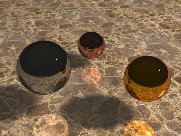

Just play with the Materials "Reflection" slider.
For the marble floor, I used the "Advanced" template, loaded up a marble texture map and set the Shininess to 60 and Reflection to 80.
For the orbs, I used the "Metal - Polished" template, adjusted the Diffuse color for each and set the Shininess to 95.
Hope that helps. :wink:

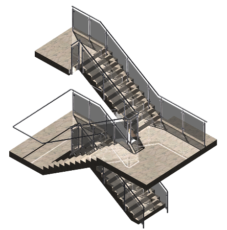

That's looking pretty good, but you might want to back off on the reflection a little bit. It's looking a little too reflective, almost like a mirror.
