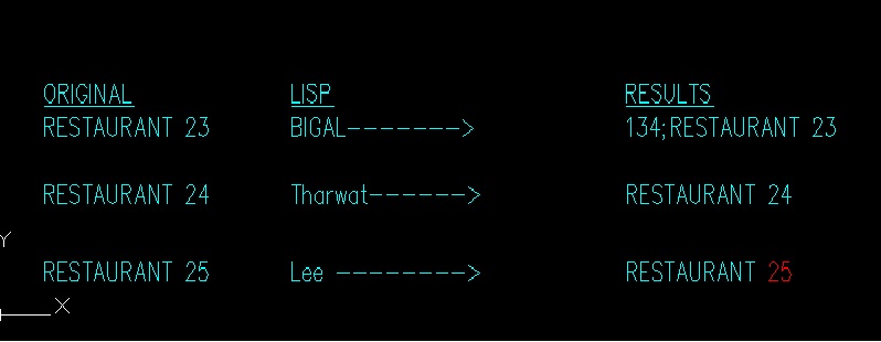

Hi guys. Thanks for the help. I was having a long weekend hence the late reply.
I tested each LISP & have different results.
I also attached the dwg for reference as well.
So far, base on my drawing I am working on, Lee's LISP work. But, only when the letters & number are the same colour.

My routine did not work or actually did not allow you to select the Mtext object because it is formatted Mtext object , so make a new Mtext with changing any format inside the Mtext dialog and try the routine once again.
Hi Tharwat
I understand what you mean. But the reason behind this LISP is to do a quick change of colours for the numbering of an existing mtext. Hence it would defeat the purpose if I were to create a new text.
Agree with you .
Just wait for Lee because he went with the best choice by using the Regular Expression ( Regex method as it is known in C# ) and it is easy to add an option to the user to pick any color they want from a Colour Dialouge .

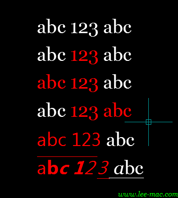

Quick demo showing compatibility with existing MText formatting:

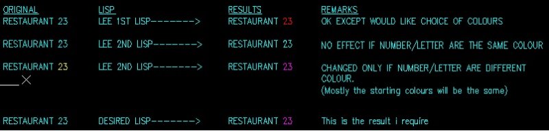

Hi Lee. Thanks for the detail explanation with the video.
Apologies but now the result is the opposite. The number cannot change colour when the letter & number is of the same colour.
It only changes when text & number is of different colour.
Perhaps there was a miscommunication.
Your initial LISP gave the result i needed (number change colour when number/letter colour is the same), except I wanted a choice of other colours.
I only mention the part where numbers do not change when number/letter is of different colour, because I though you created the initial LISP to enable the number to change regardless whether number/letter is of the same or different colours.
My drawing actually consists of only mtext with letters & numbers are of the same colour to begin with.
Hope you can revert back to the initial LISP but with a choice of colours like in the 2nd LISP. :oops:
