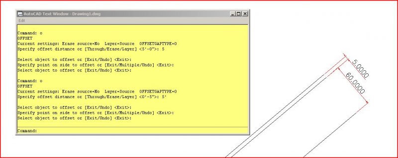

Is there a way that i can set the units on autocad that work both way decimal and architectural:
ex: i set the units type as decimal
I want to offset a line 5 inch i do: Offset then specify offset distance---- type 5--enter then it will offset.
But if i want to offset that line for 1feet, i do Offset then specify offset distance---- type 1 '--enter (Requires numeric distance, two points, or option keyword.)?? it won't offset for me. Is this possible in Autocad 2015?? thanks

Sounds like you want to have your cake and eat it too. :)
I don't believe you will be able to do that, as the decimal based dimension style won't understand the foot sign.
But in this instance typing 12 is the same number of keystrokes and easier, because they are right next to each other.

I am set on Architectural units, and the program will accept 28, 28" 2'-4", and 2.33' all for the same distance. But then again, I am not typing a space between my digits and the ' at the end. Your command line appears to have a space between the 2 and the' No spaces are allowed.

Good point Dana, thank God I rarely have to use Imperial, what a pain in the butt!
It does appear that if the UNITS are Decimal, it won't work, but as you describe does, with UNITS set to Architectural. The screenshot and commandline history were created with units set to Architectural, per your suggestion, no problem. :beer:

In my experience, decimal units is used to indicate feet, typing 1 without the foot mark gives you 1' with the foot mark being understood. Setting units to architectural does exactly as you described. If you type in 5 (no symbol), gives you 5 inches. Typing 1' is recognized as such.

why not use engineering units?
