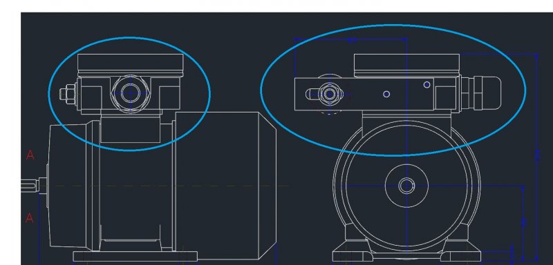

indigo Posted May 25, 2015 Posted May 25, 2015 Hi, I have a hard time visualizing the 3D View of the part on top of the motor I put a cyan circle on it can you please guide me on creating this part. Thanks.. Quote
Dana W Posted May 25, 2015 Posted May 25, 2015 So do we, have a hard time that is. You need a top view and the other end view as well. I have no idea what it may look like without them. Quote
Dana W Posted May 26, 2015 Posted May 26, 2015 The only clue is the slot.I don't have a clue where the slot is. We would also need a view of the top of the motor without the thingy on top, and a bottom view of the thingy on top of the motor, and a bottom view of the motor. Quote

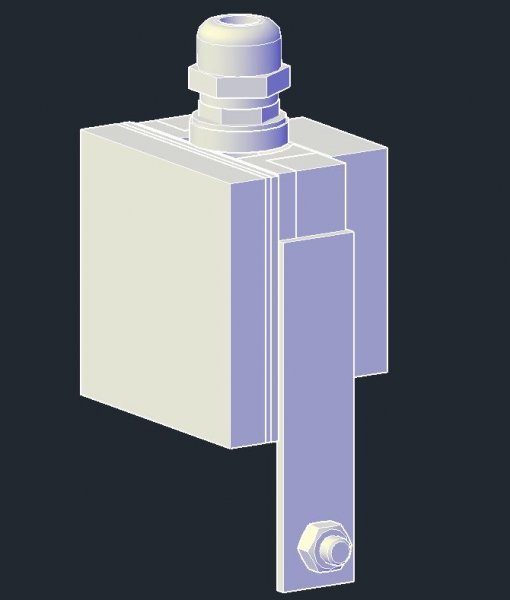

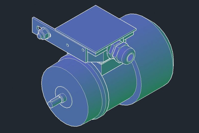

ReMark Posted May 28, 2015 Posted May 28, 2015 This is what I have accomplished so far. Still lacks a lot of detail but it gets the general point across. Quote
ReMark Posted May 28, 2015 Posted May 28, 2015 Thank you Tanner. Seems the CAD drawing differs slightly from the image on the front of the catalogue. Quote
Patrick Hughes Posted May 28, 2015 Posted May 28, 2015 Remark's done a great job of modeling it. You might have had trouble visualizing it because the 2D view projection is 1st angle. Quote

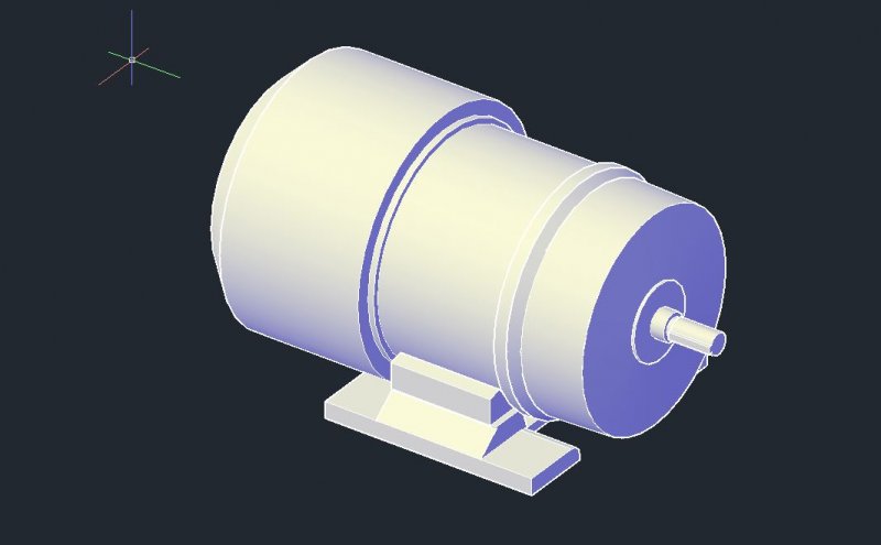

indigo Posted May 29, 2015 Author Posted May 29, 2015 Hi @ReMark this is what I have accomplished so far..Please excuse the wrong modelling..is this the catalog you use ? I only find these one and its different from the 2D drawing they provided..can you please show me how you manage to create the VFD of the motor because I really had a hard time visualizing the top part Sorry for the long post. Thanks Quote
Dadgad Posted May 29, 2015 Posted May 29, 2015 Reading the reversed Angle projection is pretty disorienting. I am always surprised when checking my coworkers' drawings, I sometimes need to mirror views to get them right, and they have been at this much longer than I. Recently resheeting some drawings which had been issued on a previous project, where they had all been issued and fabricated, but nobody else had picked up on the problem. Of course I did correct them on the drawings which are yet to be issued for this project. Being from the States I don't understand the logic behind 1st Angle projection, 3rd Angle just seems to make so much more sense. Does anybody else think that 1st angle projection is more logical, or makes more sense, other than just user familiarity? Quote
