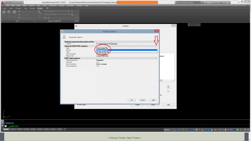

That was the problem, for some reason the dwg to pdf.pc3 was not in the drop down list, anyway I have loaded it now and am able to select it. The main problem I want to sort out is. I want to publish 6 layouts to ONE pdf file not 6 pdf files. As explained, I don't want to have to merge the files into one in Adobe. I have tried just about every setting I can find on the Google machine, but nothing works, the layouts still plot as single pdf's not ONE pdf.
Instead of "Plotter in Page Set-Up" Choose to publish to PDF. It's with that option that the PDF settings are used.

As for your other issue, use Publish or Batch Plot, but before you do, open publish options and select Multi-sheet File for your output. then on the publish/batch plot dialog, do what Rob says.
When plotting from an individual layout, you ALWAYS get one file per layout.
Don't forget to select the Model (first line of the page list), and remove it. Never mind the picture, its too danged grainy to read.
