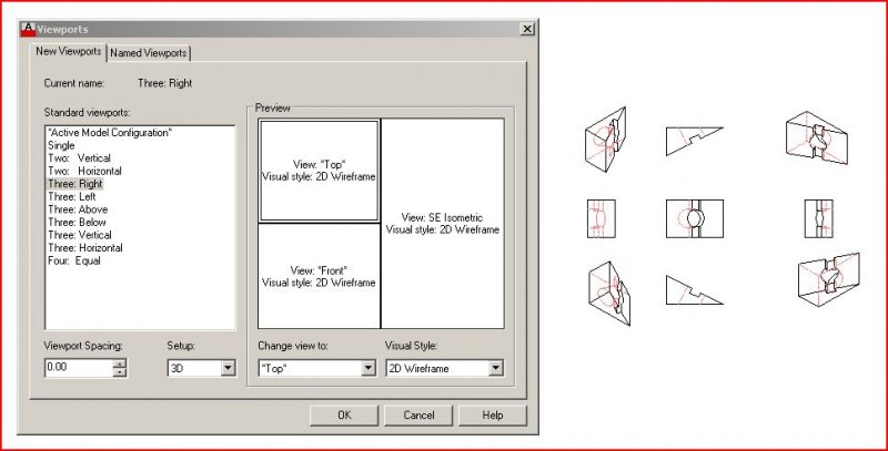

Dadgad Posted May 19, 2015 Posted May 19, 2015 (edited) Try using your VIEWPORTS configuration dialog, as shown in the screenshot, with VPORTS command. The views at the right were generated in a matter of seconds (I would never use all of them as they are redundant) using the VIEWBASE command, of which I have spoken. But they do not use viewports, so as you are meant to use viewports, you should do it the old school way. One day you might want to ask your instructor about VIEWBASE, as he may or may not even know about it. Or once you feel good about what you are working on, save a COPY of it, and using the copy, take the VIEWBASE command around the block. you'll be glad you did, even if it is not immediately intuitive. I also included a link a few posts back explaing it. Edited May 19, 2015 by Dadgad Quote

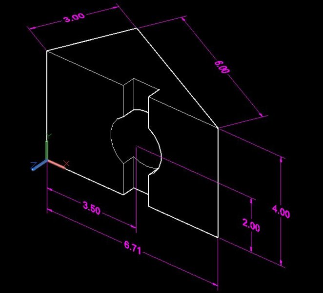

ReMark Posted May 19, 2015 Posted May 19, 2015 frankenstein19 said: i am using angular and thats what its telling me. also is there a way to remove the lines that separate each view port without removing it? Your dimensions do not line up correctly with your geometry (that probably explains why they are incorrect). You have to relocate the origin of your UCS and also make sure it is oriented in the right direction. This can be done manually via the UCS command or by using the Dynamic UCS feature. Quote
ReMark Posted May 19, 2015 Posted May 19, 2015 This is closer to what is depicted in the image of the object you were given to draw re: dimensioning. I just included a few of the dimensions for demonstration purposes. I used the Aligned dimension option for two of the dimensions (3.00 and 6.00). I also created a second dimension style so I could get a couple of the dimensions to display differently (2.00 and 4.00). Quote
Dadgad Posted May 19, 2015 Posted May 19, 2015 Thanks ReMark, that's the ticket! I had thread fatigue, couldn't bear the thought of another ancillary can of worms, extended dissertation, having not even had my morning shower nor lunch at that point. Quote
