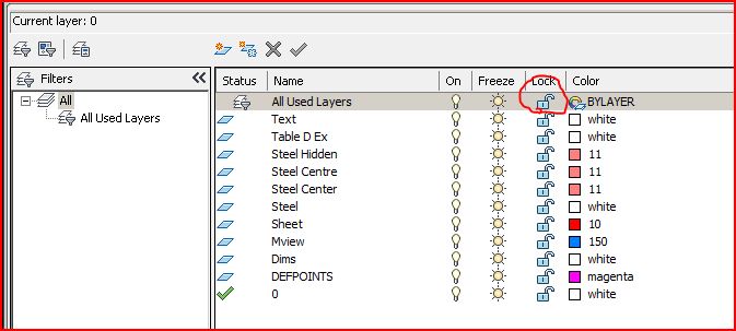

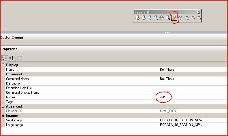

For me UNDO is not an option, I will just use the Lighning Bolt if I need to THAW ALL, or if they are set to lock in LAYISO, then unlock them all at once as shown in the layer manager screenshot.
