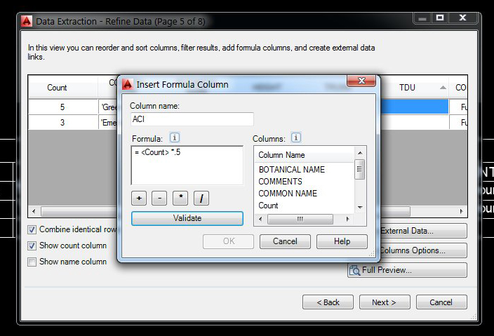

The attached image is my attempt to setup the formula within the Data Extraction setup. Sorry for the large size of the image.

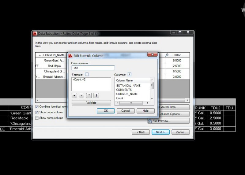

I continued to play around with the "Insert Formula Column" and finally managed to make it work.
Even though Autocad reported an error, the formula worked. Do not put an equal sign "=" in front of the formula and it may work. When i tried to multiply the column "Count" by .5, the formula did not work, however by dividing the column by 2, the formula did work!
