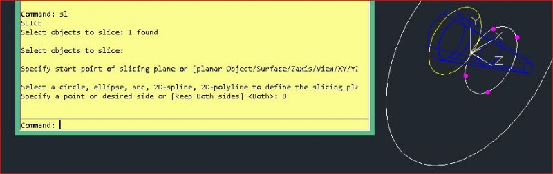

Dhanrajd Posted May 5, 2015 Posted May 5, 2015 (edited) Hello, I want to slice frustum with plane. I have frustums of various diameters and I slice them at required point slice works fine for most of my frustums, only for particular input diameter it fails and does not give any error. Please find attached dwg file. Thanks, Dhanraj Slice-Issue.dwgFetching info... Edited May 5, 2015 by Dhanrajd mistake Quote
Dadgad Posted May 5, 2015 Posted May 5, 2015 This is pretty strange. I got a non intersecting disclaimer a bunch of times, although that doesn't appear to be correct. I usually SLICE with a planar Object (the circle in this case), but I could not get that to work. The quadrant snaps did not seem to want to be picked up, as I tried to use them to define a 3Point slice plane, eventually got it to work that way. I won't pretend to understand it. I just went back into the drawing and tried it again, using the planar Object option and it worked fine, being the one with the pink dots on it. Odd for sure, wish I could explain it. Quote

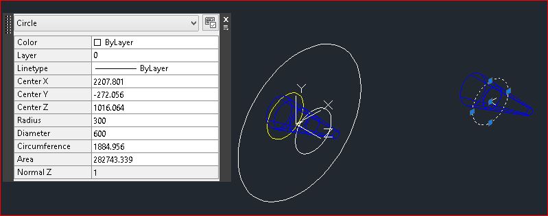

Dhanrajd Posted May 5, 2015 Author Posted May 5, 2015 Thanks for reply, but I dint understood it . Actually Plane i am creating with base point as (10,0,0) and X -axis as normal. Or planer geometry Circle is created at center 10,0,0 then it doesn't work. If you slightly move plane or circle from 10,0,0 (even 10.01,0,0) it works fine. I don't understand why it is not working at particular point . 3 point for plane I gave are 10,0,0 - 10,10,0 - and 10,10,10 Quote
Dadgad Posted May 5, 2015 Posted May 5, 2015 If you have a circle there already, just turn on the QUADRANT osnaps, and select 3 of them with your mouse. I see no need to enter the 3D coordinates, seems tedious. I am sorry I too find it weird, wish I could explain it to you. Quote

SEANT Posted May 6, 2015 Posted May 6, 2015 In this case, I hope the "A" in A Team doesn't mean answers; I don't know what's causing problems either. The GRIP on the cone seams weird. And the cone is mildly elliptical. Still, doesn't seam like that should be a problem. Quote
