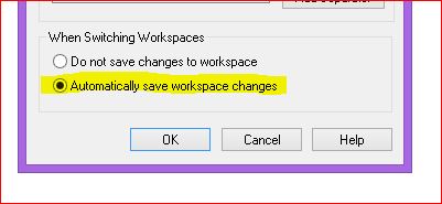

Check in your WORKSPACES SETTINGS, I think you want to have AUTOMATICALLY SAVE WORKSPACE CHANGES when switching workspaces selected,
as shown in the screenshot.

I changed to auto save but that did not help. The file tabs still disappear.
QUOTE=vernonlee;631512]I changed to auto save but that did not help. The file tabs still disappear.
That will only work when switching workspaces, if you exit AutoCAD while in a workspace changes will not be saved.

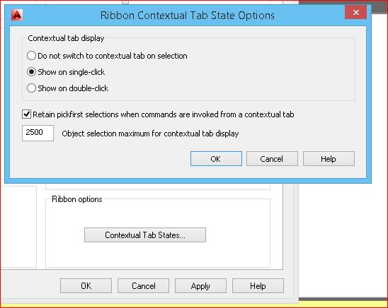

I have gone back and forth between a bunch of different workspaces, and it remembers the tab status in this one. Maybe the screenshot from the Selection tab in options might explain it.

To clarify, it is not ribbon tab & I also do not use ribbons only icons.
The file tabs that are disappearing when I switch workspaces, show the drawings that are currently opening. So each open file had a tab.
I think base on my description all should know what i am referring to.

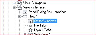

We're using the 2015 version, but I've never used file tabs. Seemed like a waste of screen space to me. I copied the "Switch Windows" Ribbon Control Element from the View tab to our Quick Access Toolbar. Even 30 drawings open (would probably blow up my PC if it ever really happened) I could easily switch to whichever drawing I want at any time. You might want to try it.
Where can i find this "Switch Windows" Ribbon Control Element"?

Look for it in Panels, not TABS.
If you find it COPY, then click on the QUICK ACCESS TOOLBAR name onto which you want to PASTE it.

THANKS MAN!
The picture was very helpful. Mine do not have VIEW INTERFACE but found it in VIEW WINDOWS
