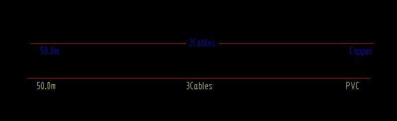

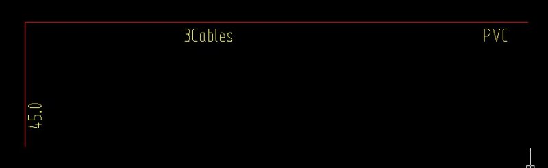

I want to create a custom line with pre-defined text in start, middle and end of line as shown in image.
The text should be 3 times per Line / Segment and Editable... Please help...! :)

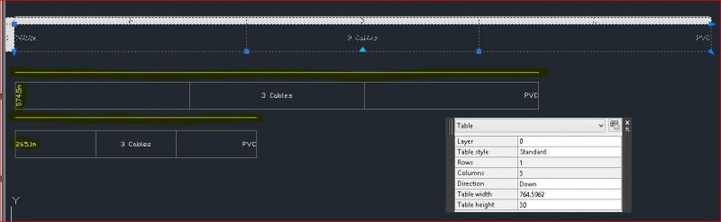

I tried doing it with a rather peculiar single row table, the left most cell of which contains a field containing the length of the line.
This is definitely not the good way to do it. I look forward to seeing a nice dynamic block solution.
My first attempt I tried to use a Dim Style devoid of arrows and extension lines, but the middle and right hand fileds got difficult,
as their positions were not self adjusting, unlike in a table.
