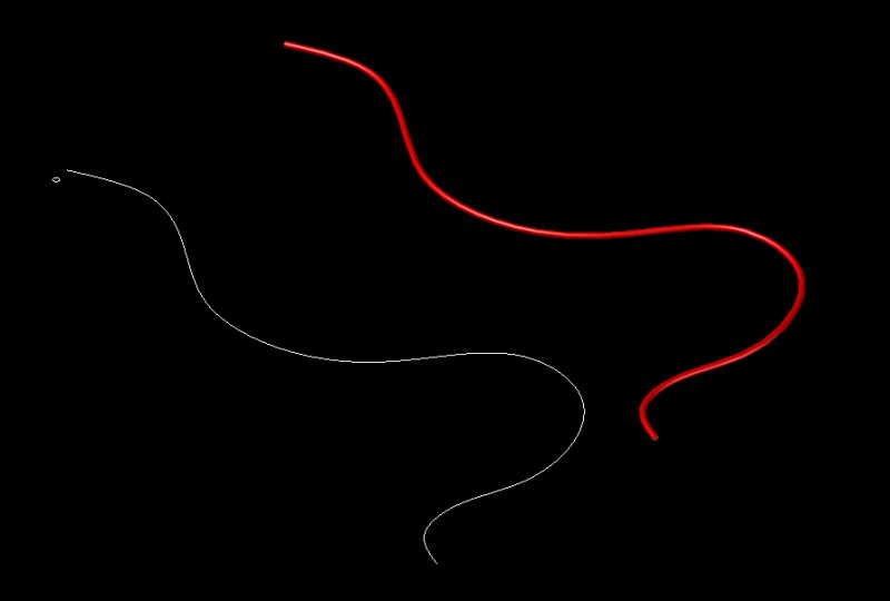

Without seeing what you are doing I'd just be guessing. Here is something I did using the Spline and Sweep commands.
BTW...I have no knowledge of how MEP works. I use plain AutoCAD.
