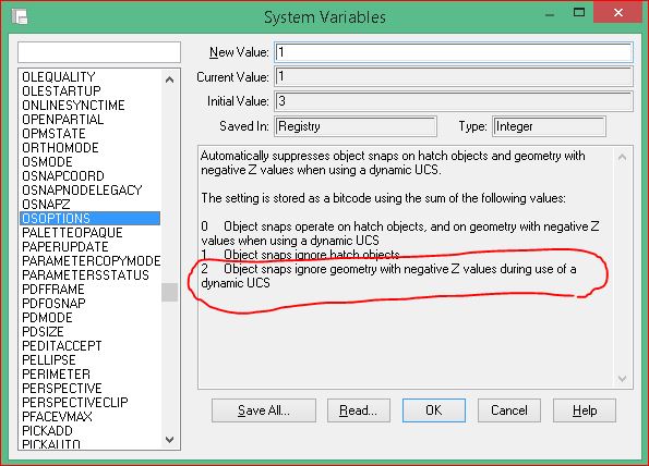

As soon as I attempt to measure certain elements, the indicated distance is far from real (Refer to Picture 1).
After Setting OSNAPZ = 1 , MEASUREGEOM indicates true distance but only after second point has been selected (as you would expect). The same applies when using DI command.
I have become accustomed to be able to read the true distance of an element without selecting a second point, but by hovering above said point instead.

Is Automatic object snap tracking on or off? Is Polar tracking on or off? Is dynamic input on or off? We can't see the blue on black in the images.

You should also check this one, as your need to change the OSNAPZ values suggests to me that this may be set to 2?
I would turn on your END Osnaps, and leave the OSNAPZ sytem variable set to 0.
The incorrect distance, as others have alluded to, is probably because of 3D elements. If you are not working in 3D it might be a good idea to make the 3D elements into 2D.
