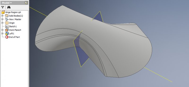

klewis Posted April 29, 2016 Posted April 29, 2016 Hinge Region.ipt I am receiving the "non-meaningful results" message when I try to apply a loft between three faces. Two are on the XZ plane and the third is on the plane perpendicular to where the other two faces meet. Is it possible to make this loft since all three faces meet at one line? Quote
JD Mather Posted May 3, 2016 Posted May 3, 2016 Your endpoints between sketches are not connected. I can say that in all my years using Inventor - I have never seen anything remotely similar to your design. Can you attach image or link to something similar to what you are trying to model? Have you ever used the Project Geometry tool to tie together sketches? Zoom way in on the corners where it "looks" like they meet. Notice that they do not meet. Quote
