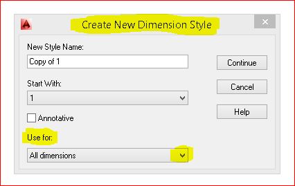

That RADIAL child (substyle) of the PARENT dimstyle allows one to specify different settings for different subtypes of dimensions, used within the same scale specified in the PARENT.
When creating a new dimstyle, you choose a starting dimstyle as your point of departure, and can specify that the style which is being created will be for SPECIFIC dimension types, like Radial, Angular, Linear, Ordinate, Diametric or Leaders & Tolerances. As shown in the screenshot, click on the icon to access the list of dimension subtypes should you wish to specify one only, as opposed to a general use dimstyle for ALL dimension types.
Edited by Dadgad

Ahh substyles. And here I was with a different dimstyle for each dimension type haha. Thanks for that Dadgad, that will come in very handy.
