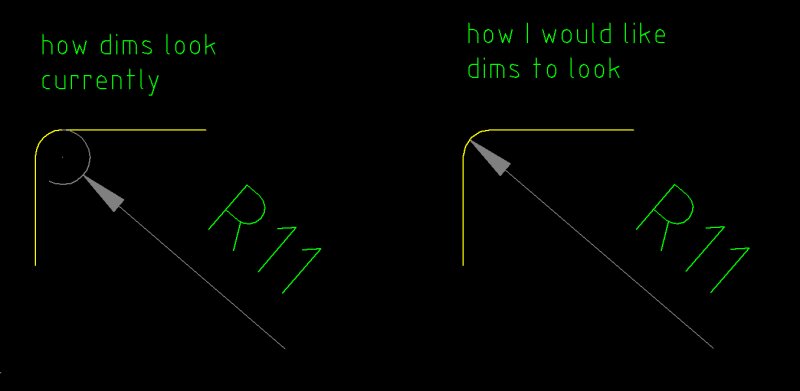

Hi guys,
Please see image below for explanation..

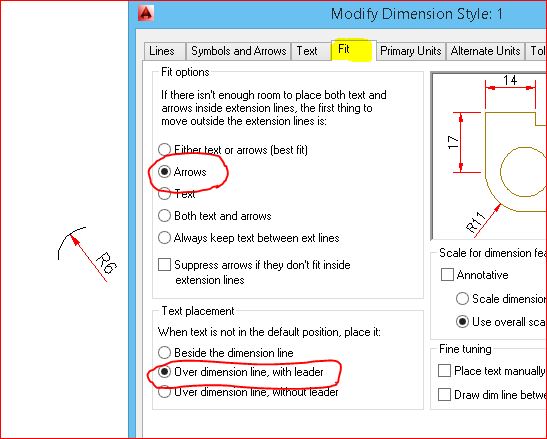

I would like to be able to remove the circle (leader?) that appears when creating Radial Dimensions, does anyone know of an option to remove this from the dimstyle?
Or any other method?
Thanks a lot for any help.

Grab the radial dimension grip and drag it around in a clockwise or a counter clockwise direction by 360 degrees, and it will switch to the other look.
These two radial dimensions are the same, but BEST FIT has been turned off on the one on the right. You can do that in the dimension style manager, as shown on the FIT tab.

Thanks for the reply. Are you referring to the grip at the text, arrow head or center of arc? From my experience, if the text grip is inside the circle/arc; then the dimension will be displayed without the circular leader (which I am trying to remove). I would like to drag the text outside the arc, but not have the circle leader displayed.

If you are looking for default behavior, try making the change in my last screenshot,
OR use the GRIP drop down menu and select MOVE TEXT ONLY.
Previously I was talking about the grip at the text, where the drop down grip menu hides, but when you rotate it around, you need to stay INSIDE of the radius length, or it will display the circle.

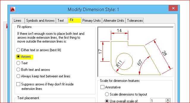

Sorry about the run around/wild goose chase, I figured it out.
Set your FIT settings as shown in this new screenshot, so that you can drag the text back past the arc center without screwing anything up.
Yes, that's exactly what I mean, Dadgad.
The only issue with this config is that it limits the ability to set the location of the dimension text. The location of the dim text is limited to a point perpendicular to the arrow head location (if you follow me).
Do you know of any way around this?

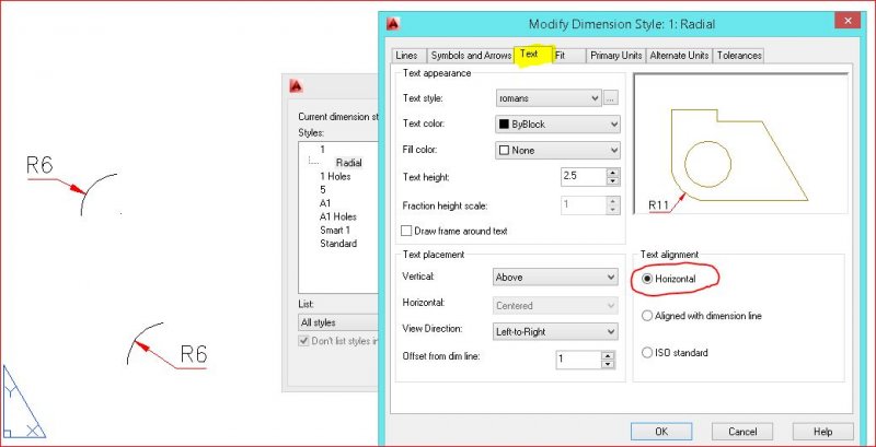

Try as shown in the screenshot.

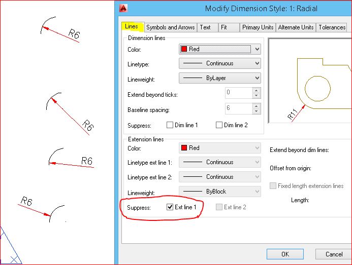

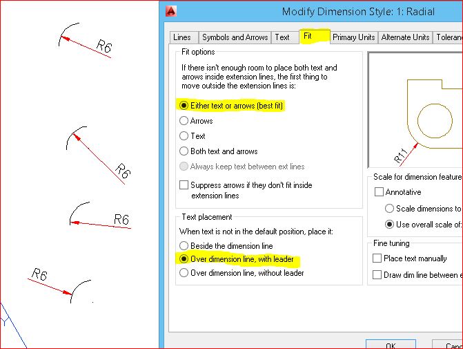

I doubt it can get any closer than this. I have suppressed EXT LINE 1 (which is the circle), on the LINES tab, as shown in the screenshot,
and changed the FIT tab to be for Best Fit, as shown in the other screen shot.
If you drag the end of the dimension line, bear in mind that it will need to cross the arc center point, to which it is anchored, to look like this.

Regarding the dimensioning... you got it almost spot on. Please see attached GIF for clarification.
Suppressing the extension line was the key. The 'text placement' option was locking the dimension line, making it non-rotatable.
Thanks for the help with that one Dadgad.

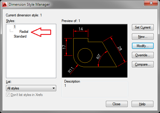

Also, what is the significance of Radial style? How was that created? It is like a style within a style.
