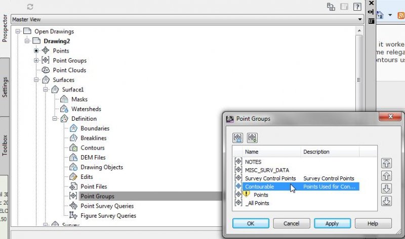

BIGAL Posted April 16, 2015 Posted April 16, 2015 You have CIV3D just read it straight in via POINTS from the ribbon or menu, just use PENZD add to a Point group say Surface. Then just create a surface from point Group Surface. Quote
