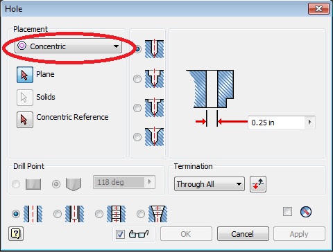

ecshclark Posted April 13, 2015 Posted April 13, 2015 Select one of the other methods found in the pull down bar under Placement. The quickest way is to select Concentric under the pulldown, since it appears the outer holes are concentric to the outside radii. But I almost always use From Sketch because it offers the most flexibility and control for locating holes, Just create a sketch and locate and constrian a point to the projected edge geometry. With both of the other methods, after creating one hole at one of the ends, use pattern to make the other 4 holes. Quote

eder_ic Posted April 14, 2015 Posted April 14, 2015 Since you have already a circular boundary, I think what you need is to set the hole as "concentric" Quote

eribiste Posted April 22, 2015 Posted April 22, 2015 You can start a New Sketch on the face that you would like the holes to start on. Place a Point on the face, then constrain it's position by using either the Constraint tools or Dimensioning the position. Finish the 2D Sketch. Invoke the Hole tool and note that the hole position method has changed to From Sketch. The tool is going to place the hole center at the Sketch Point. If there are regular, multiple incidences of a similar hole, use the Array tool to produce the other instances. As an aside, one can also use this method on a Work Plane if there are no nice convenient flat surfaces to sketch on. Quote
