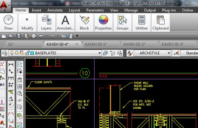

Post a screenshot of what you have now, so we'll have a clue to what "something" might be.
Here is a picture of it
Look for a little double down arrow at the end of your menu bar, next to Express Tools. If you hover your cursor over it you will see the "Show Full Ribbon" message appear. Click once on the larger of the two down arrows and your full ribbon should return.

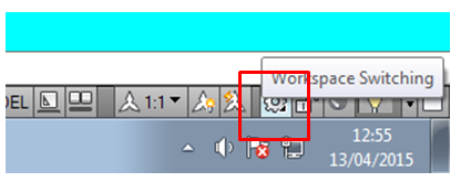

You can revert back to the default (Pre-Ribbon) Autocad by selecting the 'AutoCAD Classic' interface within workspaces.
This can be done by selectiing the workspace icon (a little cog symbol) in the bottom right hand corner of AutoCAD and select 'AutoCAD XX Classic'
