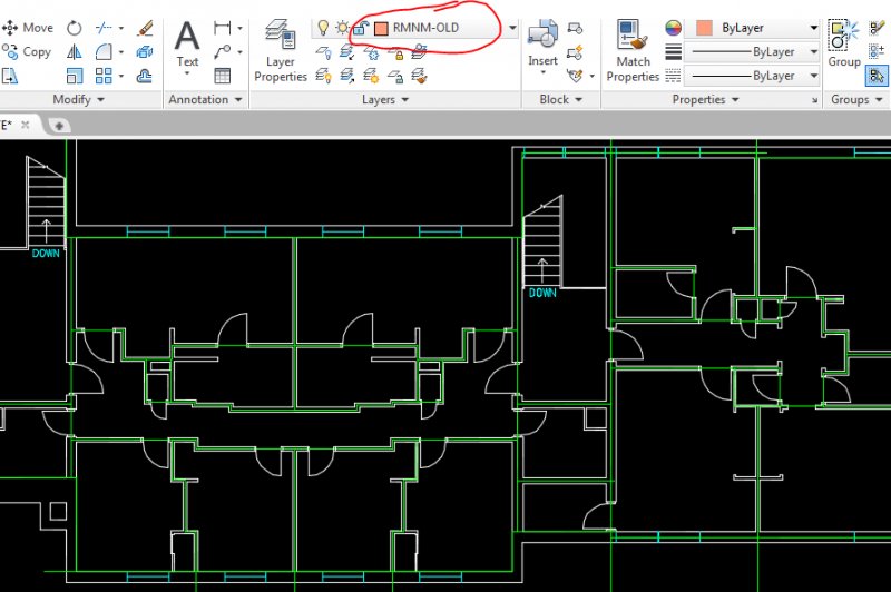

z_i_nayon Posted April 8, 2015 Posted April 8, 2015 When i am in autoCAD2007 text under layer RMNM-OLD show properly. But in autoCAD 2015 text under that layer don't show. Why is this happening. how can i solve this problem???? Thank you. Quote
z_i_nayon Posted April 8, 2015 Author Posted April 8, 2015 I don't know. That file just come from my boss. is it custom or not How can i find that ?? Quote

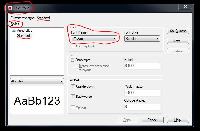

ReMark Posted April 8, 2015 Posted April 8, 2015 Ask him? In AutoCAD 2007 what is the text style name? What font style is assigned? Quote
z_i_nayon Posted April 8, 2015 Author Posted April 8, 2015 Font style is standard. How to increase fist size???? Quote
ReMark Posted April 8, 2015 Posted April 8, 2015 And what is the font name? Is it Arial? Fist size? I have no idea what you are referring to. Do you mean the font height? Is the text annotative? Quote
z_i_nayon Posted April 8, 2015 Author Posted April 8, 2015 I am sorry. That was font. I don't know font name. Boss don't know either. Is there any way i can know the font name??? Quote
ReMark Posted April 8, 2015 Posted April 8, 2015 You're not a regular user of AutoCAD are you? The STYLE command opens this dialog box. Look at the options I have circled in red. Quote

ReMark Posted April 8, 2015 Posted April 8, 2015 Which version of AutoCAD was used to produce the drawing originally? Quote
z_i_nayon Posted April 9, 2015 Author Posted April 9, 2015 https://www.dropbox.com/s/bqe2kdfgtmn91ya/NCAR04%20-%20PLATT.zip?dl=0 Here is a file. Can you please cheak it. Thanks. Quote
ReMark Posted April 9, 2015 Posted April 9, 2015 (edited) Did your CAD tech go on vacation for a few days? BTW...resetting ANNOALLVISIBLE to a value of "1" did not make a difference. It appears that someone must have deleted the text then purged the layer it was on. Edited April 9, 2015 by ReMark Quote
z_i_nayon Posted April 9, 2015 Author Posted April 9, 2015 yes. he is in a vacation. Is there anything i can do to fix it?? Quote
ReMark Posted April 9, 2015 Posted April 9, 2015 yes. he is in a vacation.Is there anything i can do to fix it?? Well you do realize that the layer itself (RMNM-OLD) is missing don't you? You can recreate the layer but the text would have to be redone. Understand? Quote
Dana W Posted April 9, 2015 Posted April 9, 2015 I hope the original copy of the drawing was not overwritten. Maybe try from the original copy again, if it is still available. Quote
