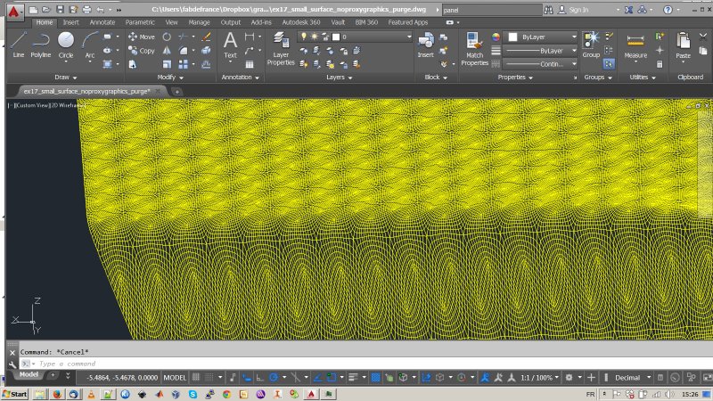

fdefrance Posted April 10, 2015 Author Posted April 10, 2015 I just tried that. (well, first I had to download the English package for AutoCAD because I realised that the name of the commands change depending on the language of the version...). The CONVTOSURFACE command lasted for almost an hour. The result is a surface, but quite an heavy one! (about 200MB when I export it in dwg or sat or igs). As you can see attached (pict), when creating the surface, a lot of lines were created to interpolate the points. I should be why the file is so big. I tried PURGE, setting PROXYGRAPHICS to 0 or converting the surface to NURBS, it didn't change the size. Why is the size so different to what you obtained? In what format did you export it? Quote

fdefrance Posted April 10, 2015 Author Posted April 10, 2015 In fact, I saved it (in dwg) and also exported it (in sat and igs). But even the saved file in .dwg is 195MB big. So, it seems like my surface is a lot heavier than yours, even though I used the same commands. I am trying to understand what happened. I attached a picture of my surface so you can compare to what you obtained. Do you also have so many lines interpolating the points? In what format did you save the file? Thank you very much for helping me. Quote

fdefrance Posted April 10, 2015 Author Posted April 10, 2015 Thanks, but you don't have to repeat. As I wrote in my previous post, I was trying to understand why I wasn't obtaining the same file size as you. I finally found out. There is a variable : SMOOTHMESHCONVERT which has to be set to 3 (or maybe 2). So, AutoCAD doesn't try to smooth the surface. By default it is set to 0, which results in a really long execution time and gives a smooth but really heavy surface. Now, the command is exectuted in 1s and I get a 9.8MB .dwg surface file, like you. Thanks for your help Quote
