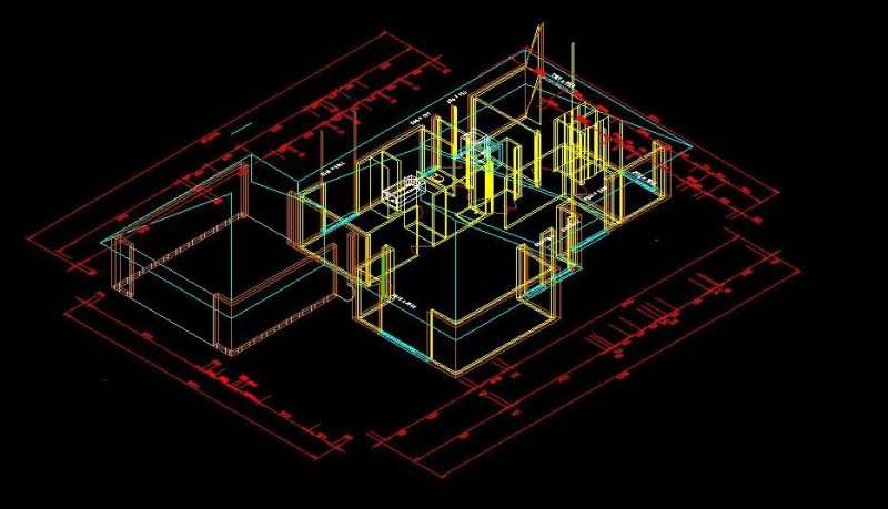

Hsanon Posted April 8, 2015 Share Posted April 8, 2015 Hi, was wondering if there was any routine which would automate dimensions in an architectural plan. This is present in refit, and we could have it in Autocad where we could draw a line through a floor plan and "stretch" the dimensions of all the intersecting lines to a convenient point. Thanks Quote Link to comment Share on other sites More sharing options...
Dadgad Posted April 8, 2015 Share Posted April 8, 2015 (edited) If I understand you correctly, without using any special code, you could use the LAYISO command, to isolate your DIMENSION layer, then use the STRETCH command to stretch all selected dimensions by the same amount. After which you would of course, use the LAYUNISO command to restore your layers to prestretch settings. Edited April 9, 2015 by Dadgad Quote Link to comment Share on other sites More sharing options...
BIGAL Posted April 9, 2015 Share Posted April 9, 2015 I have one but its copyrited hence no code, just pick left and right side and all dims appear for multiple walls etc, its 3 picks left right and dim position. So answer to the question is yes it can be done. Quote Link to comment Share on other sites More sharing options...
Hsanon Posted April 9, 2015 Author Share Posted April 9, 2015 BigAl you have understood it right.... Point is, is there any lead in this forum or elsewhere, where this utility is available ??? it will be a very useful time saving utility thanks Quote Link to comment Share on other sites More sharing options...
BIGAL Posted April 10, 2015 Share Posted April 10, 2015 The dims were auto generated. Sorry commercial in confidence. Quote Link to comment Share on other sites More sharing options...
neophoible Posted April 10, 2015 Share Posted April 10, 2015 Hi, was wondering if there was any routine which would automate dimensions in an architectural plan. This is present in refit, and we could have it in Autocad where we could draw a line through a floor plan and "stretch" the dimensions of all the intersecting lines to a convenient point.Thanks Sounds to me like that sort of routine should be worth some serious money! Quote Link to comment Share on other sites More sharing options...
Hsanon Posted April 10, 2015 Author Share Posted April 10, 2015 True, or maybe auto desk should add it in its express tools package. Lee had one program in his suite which had automatic dimensioning within circles and ellipses ..... Called Length between intersections. Could that be a basis for a dimensioning suite ???? My knowledge of lisp is not so great ..... It would be a fantastic drafting utility !!! Quote Link to comment Share on other sites More sharing options...
Hsanon Posted April 22, 2015 Author Share Posted April 22, 2015 Hey guys, i found one great routine which does most of the work that i needed..... Hopefully it will help others too who are in need of this utility. Sounds to me like that sort of routine should be worth some serious money! AUTODIM.lsp hope the money comes puring in Quote Link to comment Share on other sites More sharing options...
Hsanon Posted April 22, 2015 Author Share Posted April 22, 2015 The utility is not as good as i understood from BIGAL's sketch.... but it sure can be a start for an expert to improve on... Quote Link to comment Share on other sites More sharing options...
Wesley_Amsterdam Posted April 23, 2015 Share Posted April 23, 2015 QDIM will do the trick also... Quote Link to comment Share on other sites More sharing options...
