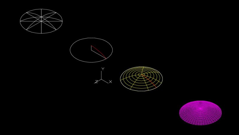

ReMark Posted April 7, 2015 Posted April 7, 2015 To create a solid you would have to sweep a closed profile (made up of a vertical line, horizontal line and arc) along the path of the circle with the 24.00 radius. To create a surface you would have to sweep only the arc along the path of the circle. Use the MESHSMOOTH command to create the mesh although the results may not be exactly what you are looking for. I'd suggest using a mesh primitive but I have no experience in working with them. Who knows, maybe it would be easier. Perhaps another member can educate us both. Quote
ReMark Posted April 7, 2015 Posted April 7, 2015 The yellow object is a surface. The magenta object is a solid. Quote

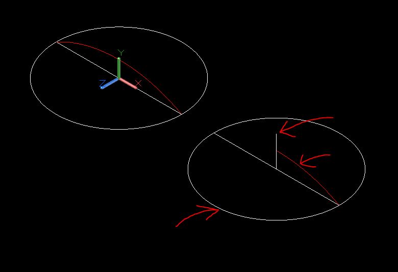

ReMark Posted April 7, 2015 Posted April 7, 2015 Think about it. You have everything you need in the roof.dxf file you uploaded. You don't need the whole arc that goes all the way across the circle you just need half of it. Reorient your UCS, draw a vertical line from the center of the circle through your arc. Trim the arc then sweep the remaining piece of arc along the path formed by the circle. Should take no more than 30 seconds. The three things you need. I still think in the end Inventor will provide you with a better solution. Quote

ReMark Posted April 7, 2015 Posted April 7, 2015 Invoke the Sweep command. Look at the command line and what you are being asked to do. Pick the object you want to sweep and then pick the path you want to follow. Object = part of arc. Path = circle. It doesn't get any easier than that. Quote

ReMark Posted April 7, 2015 Posted April 7, 2015 (edited) I thought that was a typo since your profile says 2014. There was no Sweep command in 2004. You'll have to use another command called Revolve. You also need to use the Object option and pick the vertical line. Specify an angle of -45 degrees and you should get the wedge shape you are looking for. Edited April 7, 2015 by ReMark Quote

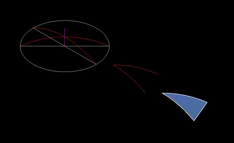

ReMark Posted April 8, 2015 Posted April 8, 2015 It's early morning and I've just had my tenth cup of coffee. Now that the brain is fully functional I figured out how to create the curved wedge as a mesh. I really should have remembered this yesterday but I was in a bit of a rush. Start with a portion of your original geometry (shown on the left) and add a vertical line. Trim the two arcs. Use the Rulesurf command and when prompted to select the first and second defining curves pick a different arc segment each time. The result will be a mesh object as seen on the right. For a smoother result change the variables SURFTAB1 and SURFTAB2 from their default of "6" to something more like "20". Or just download the attached (saved in 2000 file format). MeshCurvedWedge.dwgFetching info... Quote
wilkes704 Posted April 8, 2015 Author Posted April 8, 2015 Ah thank you! It's the compound curve that was giving me problems. I'll see if I can get this unrolled and see what happens. Quote
