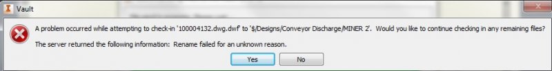

error message when checking into vault
has anyone had the error message when checking a DWG into vault that reads.
I have not attempted a rename so I don't quite understand what the error is.
Looks like a dwf not dwg. Or rather a .dwf was added to the end of the .dwg which might make it think it was renamed.
cheers mate I just don't understand WHY its there, never renamed drawing and only use .dwg template so I simply don't understand why its coming up with this, I have no issues other than this one drawing.:geek:
The DWF file is normal, that gets generated when you check in a file to Vault so you can preview the file in the Vault system correctly.
Go to Tools-->Options in your Vault Client and turn on hidden files, locate this DWF and delete it. You can always recreate these with the update button or the create visualization on check in.
