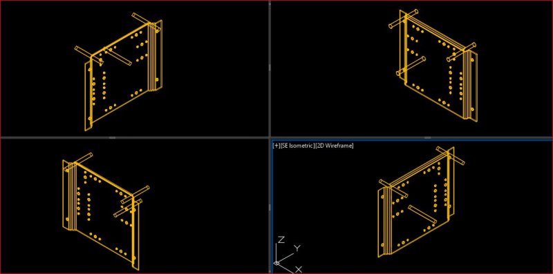

AerospaceDesk Posted April 10, 2015 Author Posted April 10, 2015 Thanks again Dadgad. It appears I am missing a basic concept of CAD. If I specify a flange to a x, y, z, coordinate at the contact points of the plate, why is it that it flies of into space as you have shown? Then what are the steps to bring them back together? Even when I use 3D Align, selecting coincident points to snap to, and all appears aligned and joined, the other view are showing the flange in outer space. If you have the time. Thanks in advance. Quote
Dadgad Posted April 10, 2015 Posted April 10, 2015 Welcome back. Try using 2D Wireframe visual style in a different isometric perspective than previously. Turn grips on, Turn your End Osnaps on if they aren't already, use the MOVE command, select it and drag an appropriate grip to the point where you want it to be in relation to the plate. Hopefully nestly will see this and do us all a big favor and grace us with one of his wonderful video clips to explain this. Quote
ReMark Posted April 10, 2015 Posted April 10, 2015 What visual style were you using when you attempted to use 3DAlign? How zoomed in were you? What view were you using? Did you attempt the alignment using a non-standard view (i.e. - using 3DOrbit)? I think your technique, whatever it was, is at fault here and not the program. Quote
AerospaceDesk Posted April 10, 2015 Author Posted April 10, 2015 I am making some progress. I managed to use Move Faces to move the out of alignment hole. It wasn't obvious to me that you had to select the face inside of the hole but that did the trick. Just bear in mind I am currently doing this in the CorelCAD 2015 trial. So getting back to the flange, I used Modify - Align which leaves little line from source to destination for 3 sources and three destinationation and with esnaps on I can pick where they have to go. When I get to the third destination, the programme goes to autosave and will not return to the cursor to pick the 3rd destination. Nevertheless, I did eventually get to lay the 3rd destination down but wasn't sure what to do next e.g hit ENTER?? Even so, nothing comes together. No doubt it is all happening in outer space but I cannot see it. Going to Modify > 3D Operations > 3DAlign lays down a base point, then a second and third point followed by first, send and third destinations. Even then nothing happens even though I have had success with this method of alignment before. I just don't understand why coordinates entered this way don't keep the 3D objects in the place they are put. It is not intuitive to me to see things fly off into space after that. Quote

AerospaceDesk Posted April 10, 2015 Author Posted April 10, 2015 Thanks ReMark. I have been using 2D Wireframe. Sometimes in Hidden to turn off the back faces. I am usually zoomed in to extents or to fit; sometimes I have to zoom in more to see if the CCS is properly set up. I have been using SE Isometric. If I change the view to other views I see my flanges flying off into space. Yeah, I am pretty sure I have found the Murphy's Law of CAD. However, if you can see where I am screwing up, I will be able to get better at it. You can get depressed with this stuff. Quote
AerospaceDesk Posted April 10, 2015 Author Posted April 10, 2015 Yes, thank you Dadgad I am trying that but silly things are happening that I don't expect. For example when I go to another Isometric view, I feel I am "out of the picture" and I only see dots; zoom in and it is the plate or flanges in space set apart. Go to the 3D modelling view and it looks great...... (Clayton's 3D obviously!!!) Quote

Dadgad Posted April 11, 2015 Posted April 11, 2015 (edited) AerospaceDesk said: Yes, thank you Dadgad I am trying that but silly things are happening that I don't expect. For example when I go to another Isometric view, I feel I am "out of the picture" and I only see dots; zoom in and it is the plate or flanges in space set apart. Go to the 3D modelling view and it looks great...... (Clayton's 3D obviously!!!) Thusfar, this whole thread has revolved around the fact that your SE Isometric view is LYING! As it is known to be unreliable, stop believing it, barring an independent confirmation from another isometric perspective that it is in fact correct. The secret to solving a problem, after repeated failures, is to stop repeating the process, and try something different. By different in this case, I mean a DIFFERENT ISOMETRIC perspective, or two, as stated ad nauseum, and as recently as post #24 of this thread. What was it Einstein said, that the definition of insanity is doing the same thing over and over, and expecting different results? The reason I asked about your grips (if they are displaying) is that they should help you get it right, and that if they were not displaying that would likely exacerbate your problem. I appreciate that you are trying to come to terms with how to do this correctly, in software with which you are not familiar. Let's not lose sight of the fact that the corrected drawing has been attached to this thread in a few places, by different forum members, aspiring to help you. How did it go at the other forum? Any smart members over there, or did they all agree with the numerous senior members of this forum? Presumably nobody came up with any new insights, since you have come back here. You could just stop trying to MOVE the old flange, adjust your UCS accordingly and recreate the flange in the correct place, starting at the appropriate vertex snaps on your base plate. If so I would strongly suggest that you choose a different perspective than SE Isometric, and I would use 2D Wireframe, don't bother to use HIDE, just pay attention. And if that still doesn't work, then take JD's advice (he's smart, he's a college professor in this field), and check out Fusion 360. And as for ReMark? Hell, he's just some guy with over 40,000 posts on this site alone, why would anybody listen to him? The other two forum members Cad64 & SLW210 are both forum administrators, who have been around the block a time or two. Bottom line, we all are, and have been trying to HELP you, hopefully you can rise to the challenge. Hey nestly, if you read this how about a little Camtasia magic? Edited April 11, 2015 by Dadgad Quote
Dadgad Posted April 11, 2015 Posted April 11, 2015 The attached screenshot, is taken from the .dwg file which I attached to post #3 in this thread, last Saturday. Actually, I just reposted the .dwg, because in revisiting it, I noticed that one of your original flange holes did not go all the way through the plate, which I took to be a mistake, and I had missed previously, so I fixed it. When your model is good, you won't need to go looking for a particular perspective in which it appears to be right, and favor that one. It will be right in ALL of them, as in the screenshot. I am reminded of the old adage, that we only believe what we want to believe. If you decide to use that one, please read the disclaimer in post #3, as I left a couple of things for you to do. Should you be unable to do them in Corelcad, let us know, and I, or someone else will be happy to finish it up for you. Quote
