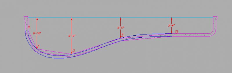

or_isnt_he Posted April 3, 2015 Posted April 3, 2015 Hi all, I design concrete swimming pools... I have a drafting issue that hopefully someone can shed some light on. I have attached a diagram for your reference. I need to draw a curved line that starts tangent to segment (A) and hits points 1-3 and ends tangent to segment (B). The floor of a pool obviously is a smooth curve, not a segmented line. I would love to be able to represent that accurately. Any ideas?? Pool Section 2.dwgFetching info... Quote
BIGAL Posted April 3, 2015 Posted April 3, 2015 Maybe play with PEDIT using F or S fit or spline it will certainly smooth your section, then offset. Quote
eldon Posted April 4, 2015 Posted April 4, 2015 Use a Spline line and specify the start and end tangents. Quote
