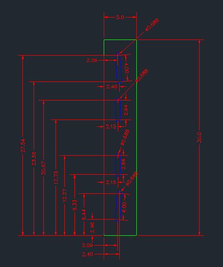

Sengna Posted April 3, 2015 Posted April 3, 2015 What is the correct way to dimension the plate with slots? Base on what i got, does it have enough info for the guys in the shop to fabricate this? Material: SS Unit: Inch Note: Forgot the thickness of the plate Quote

Dadgad Posted April 4, 2015 Posted April 4, 2015 Sengna said: [ATTACH]53619[/ATTACH]Here it is. You had plenty of dimensions on there, I should think the fabricator would be able to work from it. I changed a couple of things slightly, mostly for cosmetics. If I have non orthogonal features, like those two crooked slots, I usually slap an angular dimension onto them, although depending on the tools at hand in the shop, they may or may not be used. I usually do my dimensions in Paperspace, feels funny to me putting them in Modelspace, but that is of no consequence in this case. Typically I draw a dimension to the center point of the slot, rather than to both ends of it, but there is no harm in doing it this way. slots.dwgFetching info... Quote
Dana W Posted April 4, 2015 Posted April 4, 2015 I also recommend dimensions to the center line and radius center of rounded end slots rather than the total length. This is pretty standard because the machinist will use a round tool, aimed at the center point to make the end holes of the slots. Even a CNC machine does not care about the total length, only the center of the radii. Quote

Sengna Posted April 4, 2015 Author Posted April 4, 2015 Dadgad said: You had plenty of dimensions on there, I should think the fabricator would be able to work from it.I changed a couple of things slightly, mostly for cosmetics. If I have non orthogonal features, like those two crooked slots, I usually slap an angular dimension onto them, although depending on the tools at hand in the shop, they may or may not be used. I usually do my dimensions in Paperspace, feels funny to me putting them in Modelspace, but that is of no consequence in this case. Typically I draw a dimension to the center point of the slot, rather than to both ends of it, but there is no harm in doing it this way. Just to make sure i understan it right, when you said "I draw a dimension to the center point of the slot, rather than to both ends of it," look at my drawing at the bottom crooked slot, i had dimension from center to center of the slot 4", Is that ok or not correct? Note: one thing i can do is that i can just give one Dia of the slot .69 or 11/16" Typ instead of do each since they are all equal Dia Quote
Dana W Posted April 4, 2015 Posted April 4, 2015 Sengna said: Note: one thing i can do is that i can just give one Dia of the slot .69 or 11/16" Typ instead of do each since they are all equal DiaYou can also use a note in one or two places that says "Unless otherwise noted all slots are .69" wide, and all radii of the rounded slot ends are .345". (That is oc course if your shop standards will accept that technique.) Quote

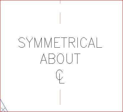

Dadgad Posted April 6, 2015 Posted April 6, 2015 (edited) Sengna said: Just to make sure i understan it right, when you said "I draw a dimension to the center point of the slot, rather than to both ends of it," look at my drawing at the bottom crooked slot, i had dimension from center to center of the slot 4", Is that ok or not correct? Note: one thing i can do is that i can just give one Dia of the slot .69 or 11/16" Typ instead of do each since they are all equal Dia As the lengths of the slots are not all the same, I would say it is a good idea to show the length between centers, along the centerline axis of the slots, as you did. I would probably just use a dimension from the end of the piece to the center of the slot. Once that point is sufficiently detailed, and the length and angle of the slot are known, the fabricator will figure it out. I now notice that the item being noted is symmetrical along the LONG axis. Typically when that is the case and I have sufficient space, I will include a note that the item is symmetrical about centerline, as that can be helpful when laying out the piece. Were it up to me, I would lay this out horizontally on my sheet, as I feel it would read better. Edited April 7, 2015 by Dadgad Quote

JD Mather Posted April 6, 2015 Posted April 6, 2015 I would have laid out a part like this horizontally rather than vertically on the sheet. Also - you current document units are Feet. Quote
