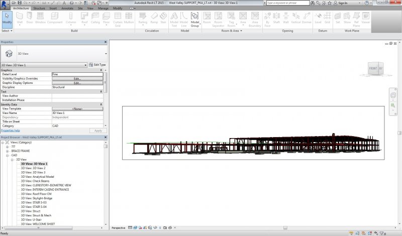

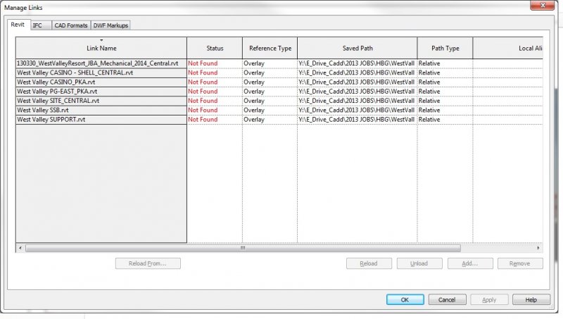

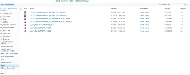

resullins Posted April 10, 2015 Author Posted April 10, 2015 Ok. That's what I thought... but for a moment, I was hopeful. I've attached three pictures. The first one is ALL The Revit files on the FTP site. I've dug through all the folders, there's nothing else there. The second is the Manage Links dialog box when I open the SUPPORT file. The third is what the model looks like when go to one of the default 3D views. It's literally nothing but the structure. Quote

tzframpton Posted April 10, 2015 Posted April 10, 2015 Okay, I see the mechanical model. And the file named "SUPPORT" is the structural model. I also see an electrical model. Just no architectural from what I can tell. So it seems like all you'd have to do is download the files, put them in a folder, and use the Reload From tool to repath to the models and everything should be hunky-dory. Quote

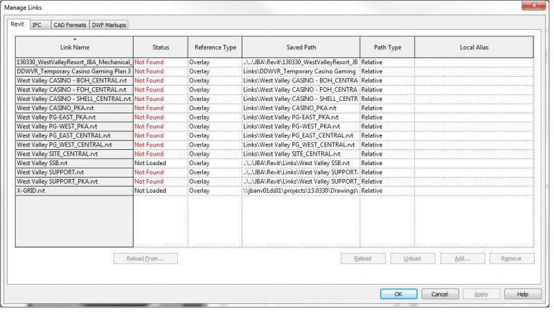

resullins Posted April 10, 2015 Author Posted April 10, 2015 But where do I download the files? They're not there?!?! Unless I'm missing something. Here's the Manage Links tab from another one of the files (the electrical). I just really feel like I'm missing the base architecture here. Quote
tzframpton Posted April 10, 2015 Posted April 10, 2015 You are missing the architectural model from what I can tell. In your previous post, you had some screenshots, and a list of all the Revit models. I'm assuming this is a screenshot of the FTP directory. I see two electrical, two mechanical and three structural models, that's it. All the "West Valley CASINO" and "West Vally PG" should be the architectural building and parking garage based off naming conventions. You need these files to complete it.... you're still missing all of these. So, contact someone, or browse deeper in the FTP directories to see if the architectural are in other locations. Quote
