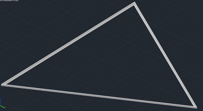

Casio47 Posted April 2, 2015 Posted April 2, 2015 Hello, I have AutoCAD Mechanical 2015. I just want to draw angle iron in 3D 61" long, with .5" sides 1/8" thick in a traiangle pattern. Basically, 3 pieces of angle iron welded together to form a triangle. Is this possible? Thanks Quote
Commandobill Posted April 2, 2015 Posted April 2, 2015 It's most definitely possible. Just draw your angle iron shape from a side view and extrude it. Then copy it a couple times and rotate. Are the edges going to be tapered, or are they going to be overlapping? Quote
Commandobill Posted April 2, 2015 Posted April 2, 2015 Maybe it would look something like this: Quote

Casio47 Posted April 2, 2015 Author Posted April 2, 2015 OK, so I drew an angle shape to represent an angle iron segment that is .5" wide and .125" thick. I then was able to extrude this drawing to a length of 51". I did this by finding the 3D basic in the drop down in modeling space (from mechanical). The problem, is now i have a piece of angle iron sticking staight up in the air along the Z axis! how do i get it to lay down, say along the X axis? Thanks Quote
ReMark Posted April 2, 2015 Posted April 2, 2015 You can rotate the angle using the 3DROTATE command or you can enable the 3D Rotate gizmo and use that. Or you could also do it manually by reorienting your UCS and then using the regular rotate command. Take a look at this. Saved in 2010 file format. 3D Triangle.dwgFetching info... Quote
