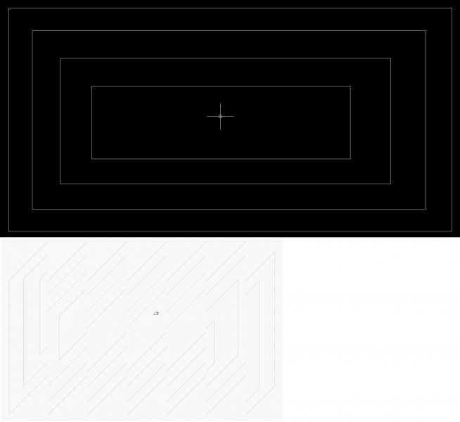

Did you try to PLOT and use the PublishtoWeb JPG.pc3?
I did and got really wierd results ???
@Steven-g what kind of "weird" results?
@ReMark i'm going to use that SnagIt and see what it will happen.. :unsure:
Try it and see, it may well be OK for you, but when I tried it it just produced a tiled image of part of the drawing at a 60 degree angle.
I've never had a problem with it, just did a few to test, all ok here.
Can you post a .dwg that does this and maybe some images of your before and after?
I use the plot to web with no problems the only thing I found was again I had to create a custom sheet size based on pixels A4 4519X3149 it seems to be locked at 200DPI so this forces a better res result.
To be honest I never use this feature, so I only discovered the problem yesterday, I do have problems with Autocad plotting on this machine that IT can't solve (but that's another story). Anyway here is an image. Print preview is fine, according to Autodesk if print preview is ok then the problem is probably with the windows drivers.
Yes, if print preview is correct, it is usually outside AutoCAD.
But, that is a plot to .jpg, just seems strange it would do that.
I did a drawing similar to yours and it came out great.
