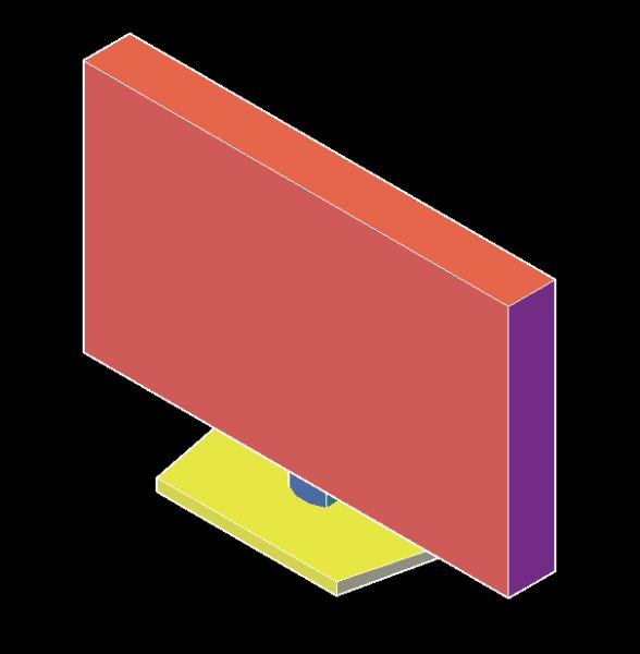

ReMark Posted March 20, 2015 Posted March 20, 2015 (edited) Is this what you are looking for? You mention the word "render". Are you intending to apply a material to your 3D model and were you also looking to display an image on the TV screen? By the way, "HELP" is not a very good title for a thread. It conveys no useful information. Help with what? Help.....why? A better thread title might have been "How do I draw a 3D TV in AutoCAD?" See the difference? Edited March 20, 2015 by ReMark Quote
Madruga_SP Posted March 20, 2015 Author Posted March 20, 2015 Is this what you are looking for? [ATTACH=CONFIG]53384[/ATTACH] You mention the word "render". Are you intending to apply a material to your 3D model and were you also looking to display an image on the TV screen? By the way, "HELP" is not a very good title for a thread. It conveys no useful information. Help with what? Help.....why? A better thread title might have been "How do I draw a 3D TV in AutoCAD?" See the difference? Thank you for the quickly replay ReMark, I'd like to put material to looks realistic, but I have no idea how to do that, to be honest. The televison looks very good! Thread "HELP" I thought is a better way, because I can't design 3D in autocad. And I thought better asking politely for help. the matter is resistance of materials. Quote
ReMark Posted March 20, 2015 Posted March 20, 2015 Descriptive thread titles would be very useful in the future. Please consider using them. You don't know how to create a 3D model from your 2D profiles do you? I can't possibly explain in detail how to apply materials to 3D models using AutoCAD 2012 in a way that would be informative to you. If you search here at CADTutor and over at the mycadsite.com you may come across some basic tutorials. Most good after-market AutoCAD books also cover the subject and I would think if you search You-Tube videos you may find video tutorials that cover the topic as well. Basically you have a couple of options. You can apply a material to an object or assign the material to a layer. You can use the standard materials that ship with AutoCAD, you can customize these materials to suit your needs or you can download or create your own materials. After materials are applied comes what I feel is the hard part and that is lights have to be inserted and positioned. You may also have to insert a background. Then and only then are you ready for the final step of rendering. This is a very brief and quite possibly incomplete description of the process. The topic of rendering has been discussed here before so there are other threads you should have a look at. Quote

ReMark Posted March 20, 2015 Posted March 20, 2015 Yes, the television is a DWG file. Take a look for yourself. MadTV.dwg Quote
