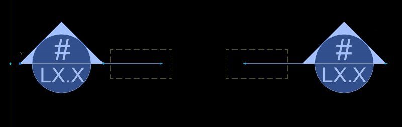

Anyway here is what was wrong with the block and how to fix it.
A stretch area box needs to be located to include the parts or portions of the object(s) you are stretching because that is what tells Autocad where to stretch. The object selection window or pick tells AutoCad what to stretch. If the where does not fall on the what, the what only gets moved, because the only thing stretching is the space in the stretch area box.
See the attached image.
The yellow dashed boxes I drew in, are where your stretch area boxes should be. Only one of your stretch area boxes is located where it will work, and that is the overall one that is only stretching space, and not selected objects. The other two are incorrectly located. If I were doing it I would also move the overall stretch area box off of any objects to avoid confusion in the future. I'd place that stretch area box right in the dead center of the empty space between all the objects.
It took a little while with trial and error to figure out which action icon went with which stretch parameter but I managed to fix it for you.
See the attached dwg.
Right click the stretch icons in the block editor and rename them to something like Overall, Left Stretch. and Right Stretch. The drafter who someday gets to modify your block will be a lot happier.
You don't have to delete the stretch actions and redo them. You left click the stretch icons in the block editor to manipulate your stretch area boxes by the corner grips to cover the portion of the lines you want to stretch. Don't try the move command for this manipulation.
