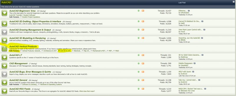

Thanks, I couldn't find this forum, it wasn't listed at the time. Doesn't seem to matter, though - I only seem to encounter problems that no one has a solution for!!
