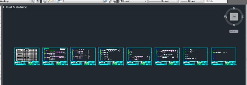

I made one dwg for SLD. All entities has been done in Model space, Totally 10 No. of sheets came (10 Title blocks has been used). I want to use publish command to generate each title block as each PDF files.

I wasn't aware that was even possible. Why don't you make each sheet a separate layout or a separate drawing?
It is possible but it would just as easy and recommended to use layouts. That is what they are there for.
If you are stuck in model space, then you will need to create a page set-up for each sheet. In publisher you will have to load the file as many times as there are sheets and select the page set-up for each sheet.
Do you really want to do all that work that is prone to errors or set-up layouts?
A way out just find every title block and plot it.

@ BIGAL
"Command: .....PRINTING DRAWING TO plotter....; error: bad argument type: lselsetp nil"
This is what I get, while using code . find the attachment for your reference.

That LISP needs a few edits for it to work for you. The printer and the .ctb for starters.
Thanks Robdraw
To the OP the name of the title block change Da1drsht, you must have the insert point of your block as lower left, you must change the hard clip plot window -6,-6 & 813,586 to suit your title block these are 6mm bigger than the corners and as commented change the plot settings to match your plotter name and sheet size.
