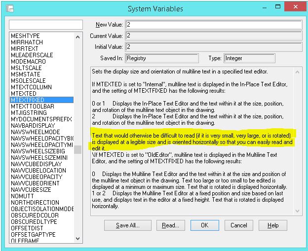

When I edit horizontal texts, they suddenly become vertical. Then I cannot to make them back to horizontal. Why? What can I do to avoid this? Thank you!

Consider the screenshot from the SYSVDLG, which likely explains what you are seeing.
no they don't return to horizontal. What should I do? I don't understand that image very much. Thanks though.
The highlighted item in the image simply says that the text editor rotates the text to horizontal so you can edit it without getting a stiff neck, and then it puts it back to vertical.
