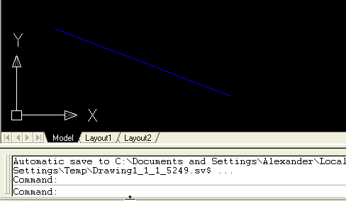

Mr ASMI
what a great lisp
related to that lisp there is one comment I want to select a text not type again.
Second, how did u do that presentation (*.GIF file)
thanx and regards

> asos2000
what a great lisp
Yes, I have some ideas. And this is one of them.
This animated *.gif is prodused with Camtasia Studio software. It provides to record on-screen user actions, add subtitles, pictures and sound also export into *.avi, *.swf, animated *.gif and some other formats.

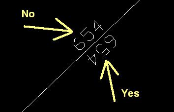

Mr. CAB
- The lisp makes a copy for the text when picking the text. see attached
- How can I change the text gap and angle When pick a text?
- When finish Aligning, Could be an option to rotate a text
Example
Rotate Text 180 Degree [Yes/No] :
it helps when rotate the UCS in viewport. See Attached
- Could the lisp crossing the text and aligning an object to another abject?
Thanx and regards
All things are possible.:)
Just put the parts you like form each lisp into one.
i dont understand,
sorry my mother tongue is not english
Mr ASMI
please read reply # 26
I just add new option "Rotate text to 0°- 90° [Yes/No]:". Look to picture. Code on my website.
I (think that CAB too) write the programs at this forum while it interestingly for us. If it is not interesting to us we do not write.

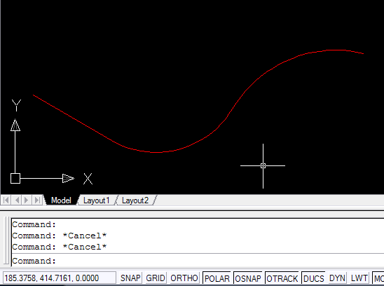

Very nice ASMI, I applaud your efforts. Only one problem... after going through all the prompts, the grvecs are displayed, and I accept the position, the text does not display. Anyone else have this problem?
Strange. Can you send to me part of your file to e-mail alex@asmitools.com. Maybe it some Civil 3D features?
> lpseifert
Thank you for example. I just fix this defect and now it works in Paper Space active viewport.
