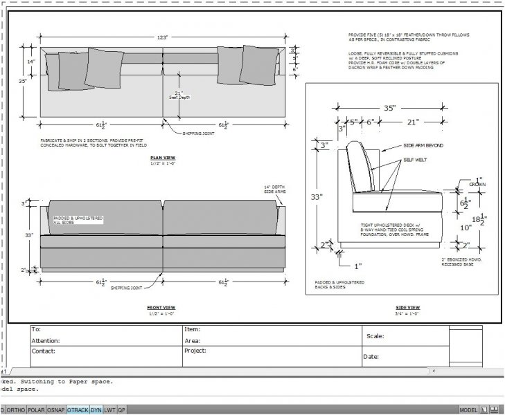

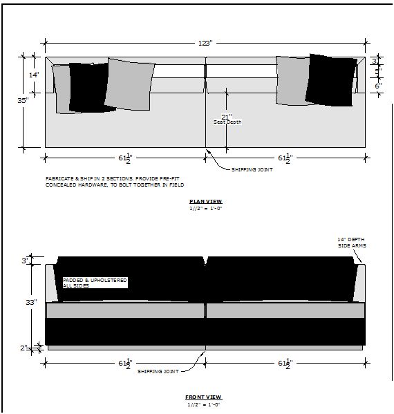

... they look fine in my Model Space, but when I switch to Paper Space, those same light shades become Black.
Then when I Plot, it's also Black :(
How can I control this, and keep my Solid Hatches in the shades I need?

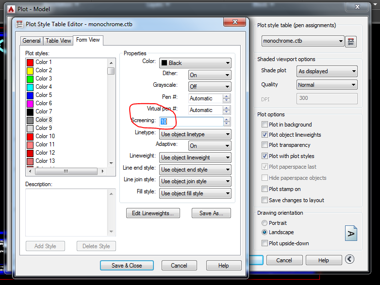

follow this in plot setting, redcue you screening percentage.
What anandhan is showing you is the plot style dialog box. Hopefully, you have already learned about this since your last post.

I've gone to the Plot Style Manager, chosen Screening 25%.ctb
Saved as TestScreening 25%.ctb, and closed.
I see no evidence that it is now being incorporated in this current project, nor do I know how to confirm that it's in use :(
I've attached a .dwg file, as well as a screen shot, after I've first inserted some sample colors, and then another of what happens when I look at a Print Preview/what that same layout prints like.
As I've stated earlier, for no obvious reason to me, occasionally these layouts print problem-free; I need to understand why.
Thanks!

Sorry, I was just checking in quickly before lunch and did not read you post very carefully. The file you posted has "Monochrome" set for the plot style. The style you are setting up needs to be applied to the layout. That can be done from the plot dialog box or with Page Set-Up.
I don't think you are as close as I thought. Have you gotten into the settings of the .ctb? Once you get in there, you can change the settings for each color that you use. You can assign different screenings and lineweights along with a handful of other settings. Get your head around that and you should be well on your way.
