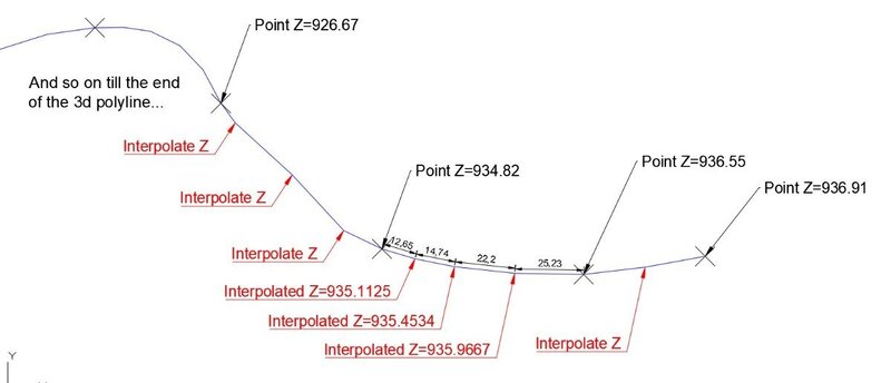

I am looking for an interpolation lisp that would work like this:
Select: first point (on 3D polyline) and set elevation
Select: second point (on 3D polyline) and set elevation
And then linearly interpolate the elevations at every vertex.
Can someone help me with this?
3D polyline interpolate elevations.dwg

Show us how you derived 10.000, 16.753, 24.195, 34.309, 42.753, 50.000 as "interpolated" value, How do you manually get this value?
Are we looking at a plan view or a section?
EDIT: Definitely plan view :)
I see, there's not too much math involved then :D. I thinks its easy, the only thing i'm not sure about is the placement of the interpoalted values , are you telling me there are no TEXT entities to start with?
Hi
Try this lisp. The selection process is a little bit trickier: The end of the polyline nearest to the selection point is the first elevation point.
It is important where you pick the polyline AND the order of elevations.

Stefan,
It works perfect. You did a great job and thanks. It will save me a lot of time with this task that I have to do. :D:notworthy:
Thanks for your replies (Stefan and pBe)
Pascal

                     p_list
        (setq pts
          (mapcar
           '(lambda (x)
              (cond
                ((vl-some '(lambda (a) (if (equal (2dp a) (2dp x) fuzz) a)) elev))
                (x)
            pts
        (vlax-put e 'coordinates (apply 'append pts))
        (vla-delete co)
  (*error* nil)
Edited by Stefan BMR
Logand expression fixed
Alternative solution:
(defun c:3dPoly_FixZ ( / doc elev enm fuzz i obj pt ss)
  (setq doc (vla-get-activedocument (vlax-get-acad-object)))
  (vla-endundomark doc)
  (vla-startundomark doc)
  (if
    (and
      (setq enm (car (entsel)))
      (setq obj (vlax-ename->vla-object enm))
      (or
        (= "AcDb3dPolyline" (vla-get-objectname obj))
        (prompt "\nError: not a 3D polyline ")
      (setq i -1)
      (setq fuzz 0.001)
      (repeat (+ (fix (vlax-curve-getendparam obj)) (if (= :vlax-true (vla-get-closed obj)) 0 1))
        (setq pt (vlax-safearray->list (vlax-variant-value (vla-get-coordinate obj (setq i (1+ i))))))
        (if
          (and
            (setq ss
              (ssget
                "_X"
                (list
                  '(410 . "Model")
                  '(0 . "POINT")
                  '(-4 . "<AND")
                    '(-4 . ">,>,*") (cons 10 (mapcar '- pt (list fuzz fuzz 0.0)))
                    '(-4 . "<,<,*") (cons 10 (mapcar '+ pt (list fuzz fuzz 0.0)))
                  '(-4 . "AND>")
              (caddr pt)
              (setq elev (caddr (vlax-get (vlax-ename->vla-object (ssname ss 0)) 'coordinates)))
          (vla-put-coordinate obj i (vlax-3d-point (list (car pt) (cadr pt) elev)))
I think one missing thing in
@Stefan BMR code
This :
(= (logand 8 (getvar 'undoctl)))
Should be :
(= 8 (logand 8 (getvar 'undoctl)))
This is all I saw for lacks, maybe there are more, but I haven't tested it...
M.R.
Hello to all, I want to thank you for your time to solve my problem. I come with the mentioning that all three codes are going very well. I tested each one
Thank you again for your involvement in my problem 😀
@Stefan BMR code
This :
Should be :
M.R.
OOPS
Fixed above
  • 2 years later...
On 3/12/2015 at 12:00 AM, Stefan BMR said:
Hi
(defun c:test ( / l2p e p h1 h2 h l_tot a d s lp)
(defun l2p (l) (if l (cons (list (car l) (cadr l) (caddr l)) (l2p (cdddr l)))))
(if
 (and
   (setq e (entsel "\nSelect 3DPolyline near to the desired start: "))
   (setq p (cadr e))
   (eq (cdr (assoc 0 (entget (setq e (car e))))) "POLYLINE")
   (= 8 (logand (cdr (assoc 70 (entget e))) )
   (setq h1 (getdist "\nStart Elevation: "))
   (setq h2 (getdist "\nEnd Elevation: "))
   (setq lp (l2p (vlax-get (vlax-ename->vla-object e) 'coordinates)))
   (if
     (> (vlax-curve-getdistatpoint e (vlax-curve-getclosestpointtoprojection e p (getvar 'viewdir)))
        (/ (vlax-curve-getdistatpoint e (vlax-curve-getendpoint e)) 2.0)
     (setq h h1 h1 h2 h2 h)
   (setq lp (mapcar '(lambda (x) (list (car x) (cadr x) 0.0)) lp)
         l_tot (apply '+ (mapcar 'distance lp (cdr lp)))
         a (/ (- h2 h1) l_tot)
         d 0
         s (car lp)
         lp (mapcar
              '(lambda (x / p)
                 (setq d (+ d (distance s x))
                       p (list (car x) (cadr x) (+ h1 (* d a)))
                       s x)
                 p
               lp
   (vlax-put (vlax-ename->vla-object e) 'coordinates (apply 'append lp))
Hi! Thank you for this LISP. I was trying to use this and in command bar it says: ; error: malformed list on input.
Can you please look into this? Thank you.
Fixed in the original post.
