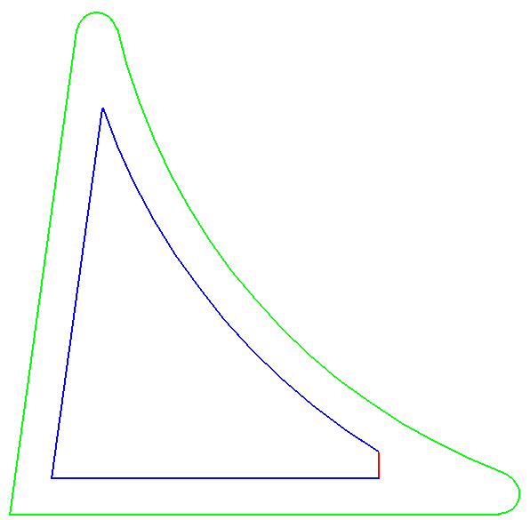

Is there a command or routine that can be used to create corners of two lines/arcs, just like the fillet command does, but square instead?
What I'm looking for is a way add that red line by specifying how long it should be and between what lines (perpendicular to the first picked line or equal angle between two)
Any ideas?
Thank you.
Fillet with a Radius of 0, what red line?
Ok now that you edit your image, NO unless you use the line command with osnaps "Perpendicular and end"
fillet with radius 0 will just extend the lines until they meet, or use arc if lines are parallel.
The red line is on attached screenshot - right corner of blue triangle.

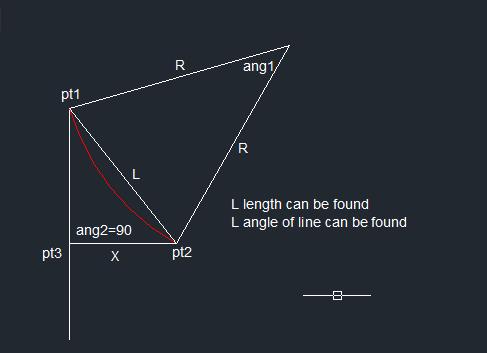

Using lisp a couple of answers if two lines then there is a simple mathematical answer, I would expect arc also, an alterntive PRE 2000 Autocad is using TRIM draw a vertical line and trim using the arc and line check its length if less than then undo all move a tiny amount and redo until tolerance is achieved, The math method is best will need to find a formula for an arc. Need some time to work out how to iterate through to achieve desired length.
Edited by BIGAL
I think we all overlooked the simple manual answer offset the line and use trim arc add line trim again erase line. I did get a lisp to work but cheated in the testing it just drew a perp point from the intersection pt of the arc and repeated till correct length with tolerance. Will see if I can find time to put code together.
Offsetting lines and use it's crossovers seems to produce satisfied results (at least for my application)
Drawing2.dwg
Had a play and problem is with arc and line need say 4 versions so it runs in correct direction, this will work with top example in your post but not bottom left, maybe a macro would be easiest if you only have a few.
