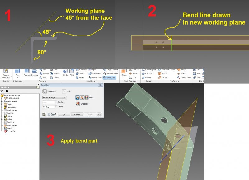

Hello I have a question, I need to bend an angle on its heel, I already did it, but whati did is to find the angle component on one face and then repeat it on the other face. But what I want is to use its local Z axis as bending line so that I use only one value and manipulate this value.
How do I have to draw the banding line to do that, I have tryed it without succes, any recomendation?.
Here I attach some pics, thanks
Well, I already solved my issue. Here is what I did in case someone is interested.
