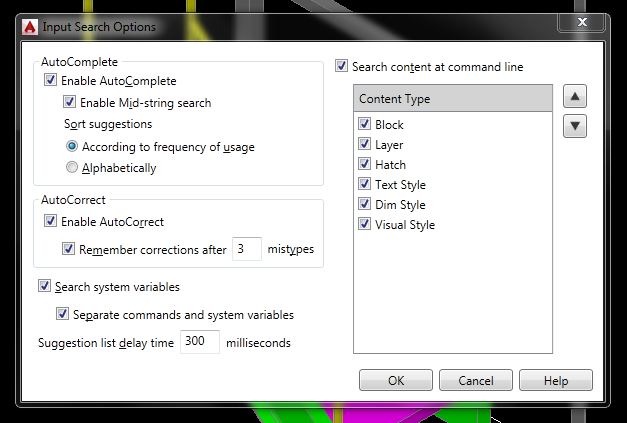

It could be the AUTOCOMPLETE feature. Invoke the INPUTSEARCHOPTIONS command and disable it.
Do you not want the list, or do you want to change the order of the list?
You may be able to solve both/either by adjusting INPUTSEARCHOPTIONS
That list can be quite helpful, like if you can't quite remember the name of a command or it's too long time to type every time. It's my understanding that the list self adjusting. Most commonly used commands should start appearing at the top of the list. There is also a delay setting that can be adjusted to a longer time so that the list doesn't appear too quickly.

Type the variable at the command line, press the Enter key and it should bring up a dialog box with several options.

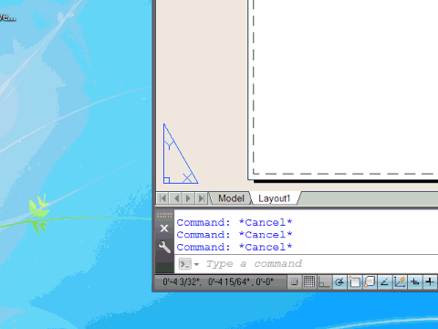

Are you using 2014 as shown in your Profile? (AutoCAD for Mac perhaps?) There should be a wrench icon at the left of the Command Line.

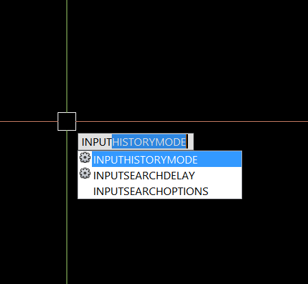

The very feature you are trying to manipulate will tell you whether or not INPUTSEARCHOPTIONS exists. Just type INPUT, and see what the list shows you. I am pretty sure if the Search List shows up, the command to get to its editor dialog has to be there.
It is available in 2015 LT. No reason why it should not show up in full 2014, except for spelling, maybe.

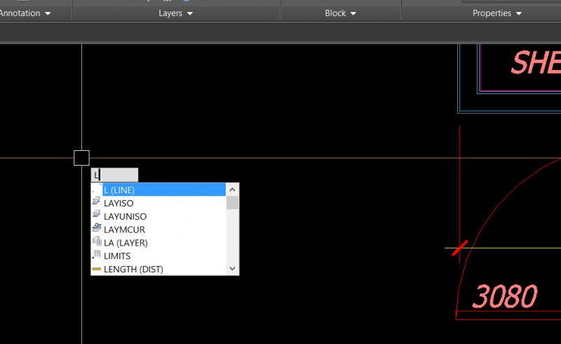

I wonder. When I type "L", LINE is first on my list, and I have it set to "According to frequency of Usage". Weird because I almost never use regular lines, about 99% polylines instead.
Pretty sure it's according to frequency for "matching" search criteria. ie when you type "L" only commands that begin with "L" are sorted either alphabetically or by frequency. "LI" would sort only commands that begin with "LI" by frequency ie Line, Limits, Lights etc. "PolyLIne" would still be on the list, but only after all the "LI" matches
Not that it matters at all, but I get this... 2,3,4, & 7 I use all the time, 1,5, & 6 never.
Help says it is by frequency of usage, but you're probably right in that it has a lot to do with the matching. It is feeding me "L" simply because it is apha sorted ahead of "LA' and "L" is all I typed. And it is a loooooooooooooooong list of everything that matches "L".
