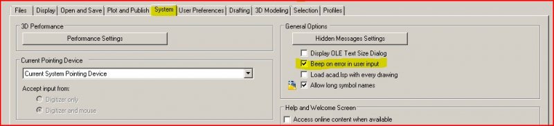

The sound you are hearing is likely due to the OPTIONS setting,
as shown in the screenshot.
