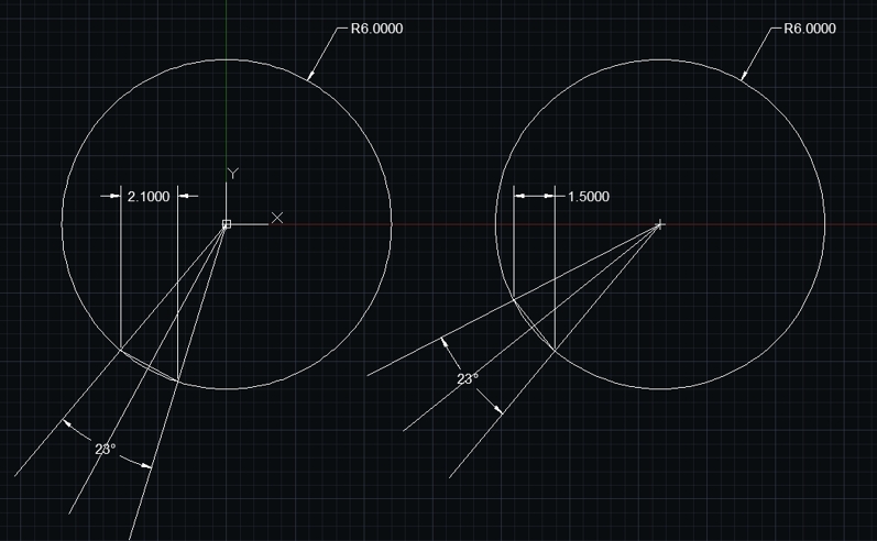

i need one command that can drawing arc of circle with given length, radius, central angle, whether exist this command in autolisp or visual lisp? i expressed my mean in below figure.
please help me

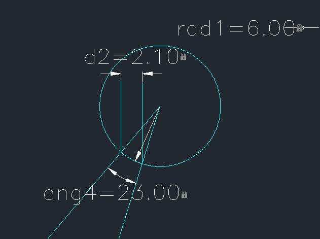

Interesting math problem. I don't know lisp, but if we set up those angled lines such that the bisector was vertical then those rays should be rotated by:
ACOS(d2/(2*rad1*SIN(ang4/2.0)))

Something overlooked you have 3 variables but the d and the angle are independent only one can be used but op asked for all 3 only 1 solution as shown in image change angle d changes
I don't think the 2.1 (d2) is intended to be the chord. If it were the chord, then the ang4 and d2 could not vary.
I think d2 is the projection of the chord based on the rotation angle of the system. So, for instance, if d2 needed to be 1.5, the system would need further rotation.

In another thread by the OP (since deleted), the central angle seemed to vary. The radius and two parallel vertical lines were constant. As the central angle could vary between 49.4584 degrees and 20.1573 degrees (approximately) I was wondering whether there would be further information.
But with the information in this thread, there is only one solution.
Not having access to Constraints, I wonder if there is an easy solution using them.

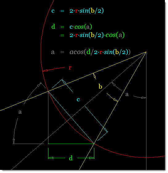

Agreed - this was my derivation:
Though, there are of course 4 possible solutions - one of each quadrant of the circle.
