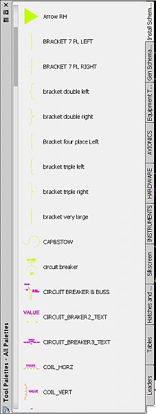

kingdaddy Posted December 16, 2008 Posted December 16, 2008 Is this possible? All my blocks are made in a black background so many of the colors are not visable in the preview pain of either the Design Center or Palette Groups. Quote

kingdaddy Posted May 15, 2009 Author Posted May 15, 2009 StykFacE said: do screen captures of the block in Model Space and make a little thumbnail image of it, then save it to a location that is easily accessible. Go to each block on the Tool Palette, right click > Specify Image and choose the newly created thumbnail. That seems like a lot of work, I have about 600 blocks that would need to be done. Seems the Autodesk guys forgot that some of us use a different color background then White and therefore draw in line colors that best match the background. In my case I use a Black background so much of my lines are yellow or Cyan which will not show up on a White background. Not very forward thinking by the software engineers to have every background color changeable except the Design Center or Tool Pallets. Ive mentioned this to them many times before, they just dont seem to get it. Quote

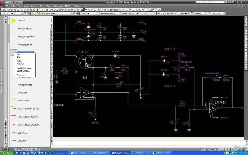

kingdaddy Posted May 15, 2009 Author Posted May 15, 2009 Its just not working for me. I cant get to the Block Editor no matter what I try. When I Right Click this is all I get (see attachemnt). Quote
tzframpton Posted May 15, 2009 Posted May 15, 2009 ah, you're using LT, that's why. Just go to the file where you have the block itself saved. Then make the changes, save/close. THEN go back to the Tool Palette and click "Update Tool Image". Quote

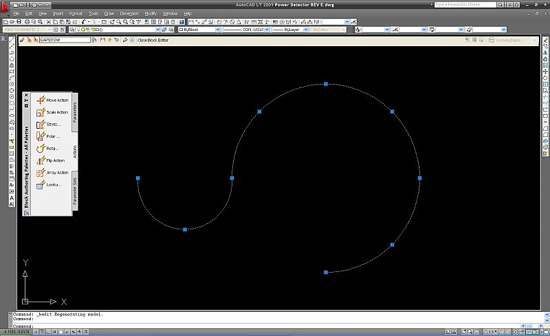

tzframpton Posted May 15, 2009 Posted May 15, 2009 kingdaddy said: I know where it is, I have made a Folder called "Blocks" in "My Documents" and this is where all my blocks are. If I go there and open the Block like I would a drawing and drop down the "Color Control" dialog and select "By Block" it still doesn’t show the Black Background that I need to see the block properly. type BEDIT and edit the block objects, not the block itself. Quote

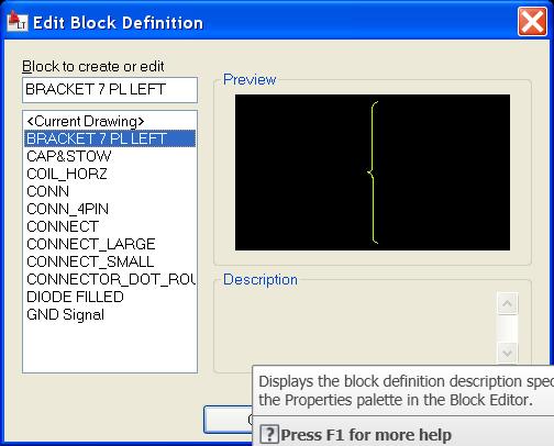

kingdaddy Posted May 15, 2009 Author Posted May 15, 2009 If I go to “Tools” “Block Editor” and select a block from the list then its shows the black background, but not in the Palette its self. Quote
tzframpton Posted May 15, 2009 Posted May 15, 2009 kingdaddy said: If I go to “Tools” “Block Editor” and select a block from the list then its shows the black background, but not in the Palette its self. .......... Huh?? Quote
kingdaddy Posted May 15, 2009 Author Posted May 15, 2009 bedit command. Here is all I see, no edit options though. Quote
