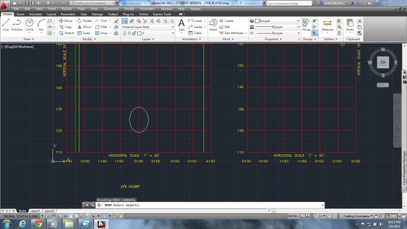

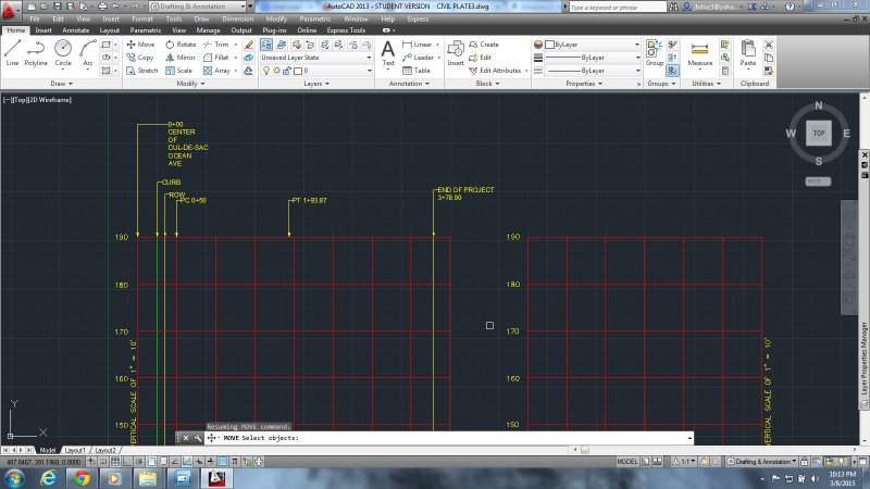

need some help did I miss something on plate 2? here are the instructions.
DRAWING THE DRIVEWAY
PROFILE AND SECTION A
PROFILE (PLATE 3)
A driveway (or roadway) profile and associated sections are
helpful when calculating the quantities of materials to add or
remove from the building site. Your driveway profile begins at
the center of the cul-de-sac on Ocean Avenue and runs the
entire length of the driveway’s centerline.
• For the driveway profile, use a vertical scale of 1″ = 10′
and a horizontal scale of 1″ = 60′. Show the stationing,
however, in 50-foot increments. Therefore, when plotting
the drawing, the distance between Station 0 + 00 and
Station 0 + 50 will be 5/6 of an inch.
1. Label Sta. 0 + 00 (Center of Cul-de-sac Ocean
Ave.), the curb, the ROW, the PC, the PT, and the
stationing at the end of driveway.
2. Use Layer Details with the appropriate hatch
patterns to show the cut and/or fill in the cross
section. Don’t forget to show the culvert as an
ellipse. You can make the culvert larger than it
actually is. This way, it’s easier to see on this
drawing. Indicate the culvert’s true diameter
next to the ellipse.
ive read the thread from car5858 and remark. the detail i don't get where it comes from. i'm going to read plate 2 again.
