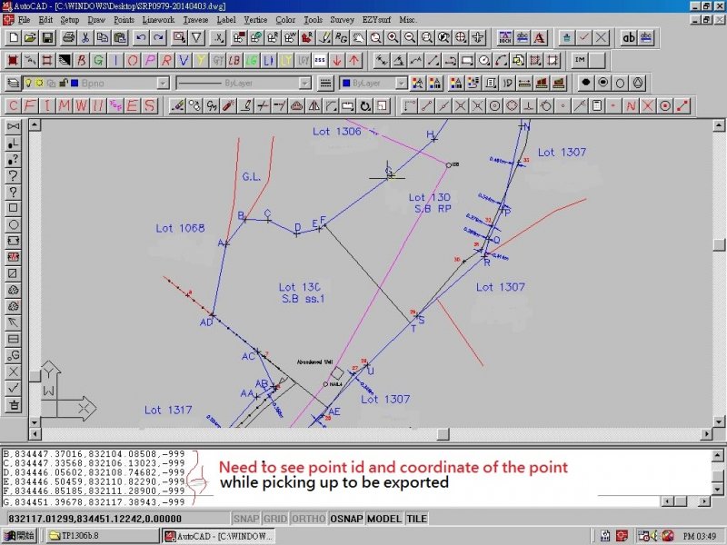

I'm using the coort.lsp which I found here to export the Point name and coordinate of a point for mu survey project. Is it possible to show the point name, northing, easting and elevation of the point in the command line when I picking up points to export?
Just like
Pt Northing Easting Elevation _> This line may not be show
A, 812822.123, 838256.869, 123.999
B, 823659.555, 836555.145, 236.159
C, 825699.478, 825167.156, 555.555
Many thanks.

I'm using R14. So I can use the uploaded lsp in practice.
Okay , give an example of the outcome to know how to write something in this regard .
Pls see the attached image. I need to see point id, northing, easting & height of each selected point while picking up the points to be export.
Easy create a block with 1 attribute the description use Dataextract and its all done. Via a lisp again use a block with insertion pt as the point. You can also have attributes as Fields equal to x y z double click you will see.

I'm new in lsp and can you do it for me? Thanks!!!
Clarify these notes :
* You have point OBJECTS that already existed in your drawing or you want to specify a point by user - by clicking on screen one by one ?
* The alphabetical characters that shown in your snapshot are already existed or you want to add them by the program as an indicator to each point in the txt file while exporting them ?
To make it clear post a sample dwg.
That's what I meant by practical example in my first post. ;)
