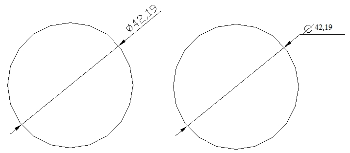

I need that diameter or radius dimension arrow with the text would be horizontal. (picture in RIGHT)
But I have only straight arrows with text. :unsure: (picture in LEFT)
What should I do?
What should I do?
In your dimension style, click modify, click text tab and under text alignment click horizontal.
You should play around the settings, you will probably get what you are looking for :)
Oh thank you :) Well experience comes in time. I can't try everything in this program, so I'm trying to draw only drawings which I've got from my lector and so I'm learning something new.
create a new dimension style. command:d
then see around many changes u can make in your dimension type. For the convinience there's preview facility there.
Hope u get more ideas there. Change and learn around.
