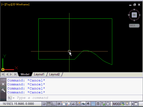

nestly Posted February 18, 2015 Posted February 18, 2015 I had no trouble using BOUNDARY to create a REGION, which then EXTRUDEd without issue. PRESSPULL was a bit sensitive about the viewing angle, but it too EXTRUDEd a Solid after Orbiting to a slightly different view. Quote

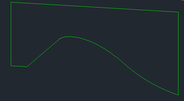

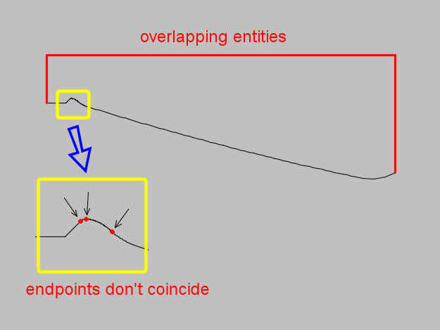

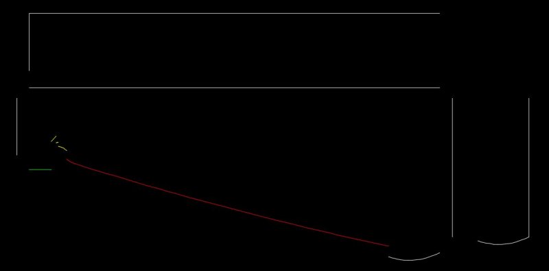

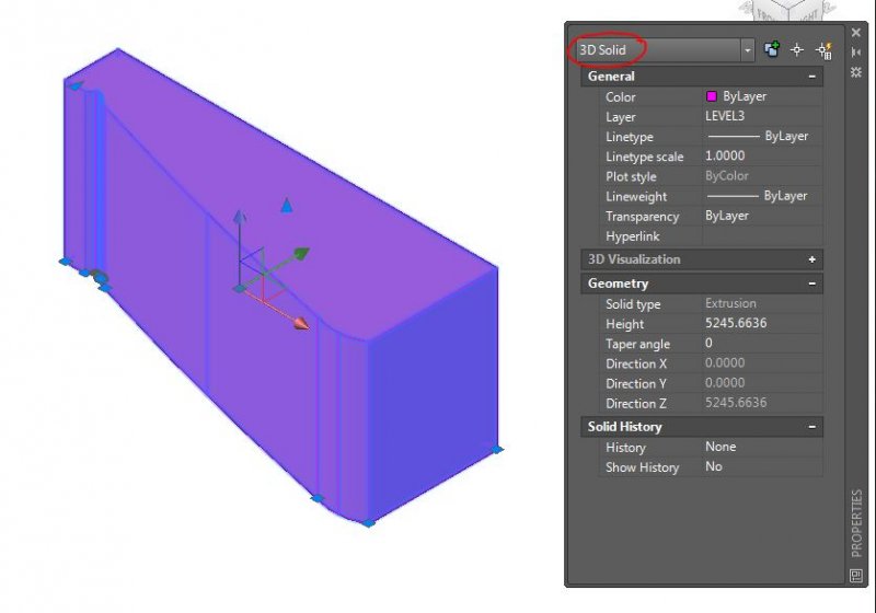

ReMark Posted February 19, 2015 Posted February 19, 2015 (edited) Is this the result that you are trying to achieve? Note: the profile was converted to a polyline as per the title of this thread. I have a couple of questions. 1. Why do you assign the same color to all your layers? 2. Did you know that parts of the profile are duplicates? Refer to the image below. 3. Two of your splines appear to be straight segments. Why didn't you use a single polyline instead? You have four layers: 0, LEVEL1, LEVEL2, and LEVEL3. All four layers use the color white. For the sake of clarity in the above image I assigned the color red to LEVEL1, yellow to LEVEL2 and green to LEVEL3. Note: There are six objects on layer 0. Two are polylines, three are lines; one is an arc. There is one spline on LEVEL1. There are three splines on LEVEL2. Sorry, the color yellow does not show up well in the image. Objects are between the green and red splines. There is one spline on LEVEL3. Why are there five splines on three different levels? I don't understand why you do this. Could you enlighten us please? Edited February 19, 2015 by ReMark Quote
